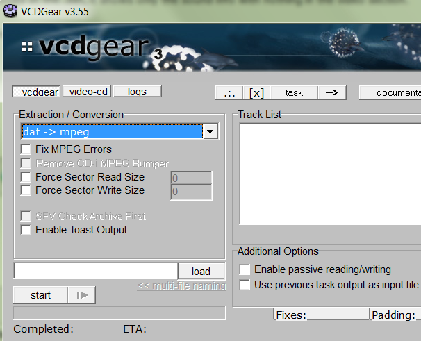

  2. Thank mate, actually already tried VCDGear v3.55 trying all options eg Fix MPEG Errors selected, same problem, no good. Unless there is some other setting that i missed.

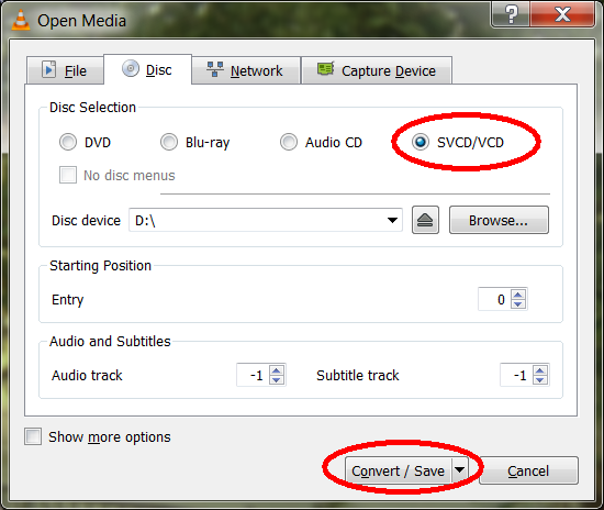

  9. If you can play VCD in Vlc player
    you can record in Vlc to video file
