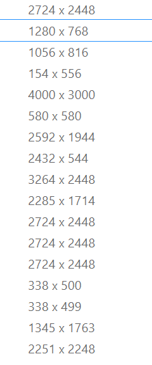

    I would like to use Mencoder to create a slideshow video from a set of photos. Unfortunately, not all the photos are of the same resolution or orientation. Using a command
    mencoder mf://@files.lst -mf w=1920:h=1080:fps=0.3:type=jpg -ovc lavc -lavcopts vcodec=mpeg4:autoaspect=1:mbd=2:trell -oac copy -o output.avi
    makes an output video that scales (stretches) all photos that are of any other aspect ration than the "normal" 16:9 landscape photo.
    How can I make it not to stretch photos, but instead zoom them out and maintain original aspect ratio.

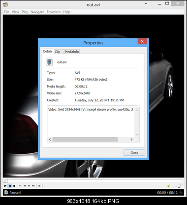

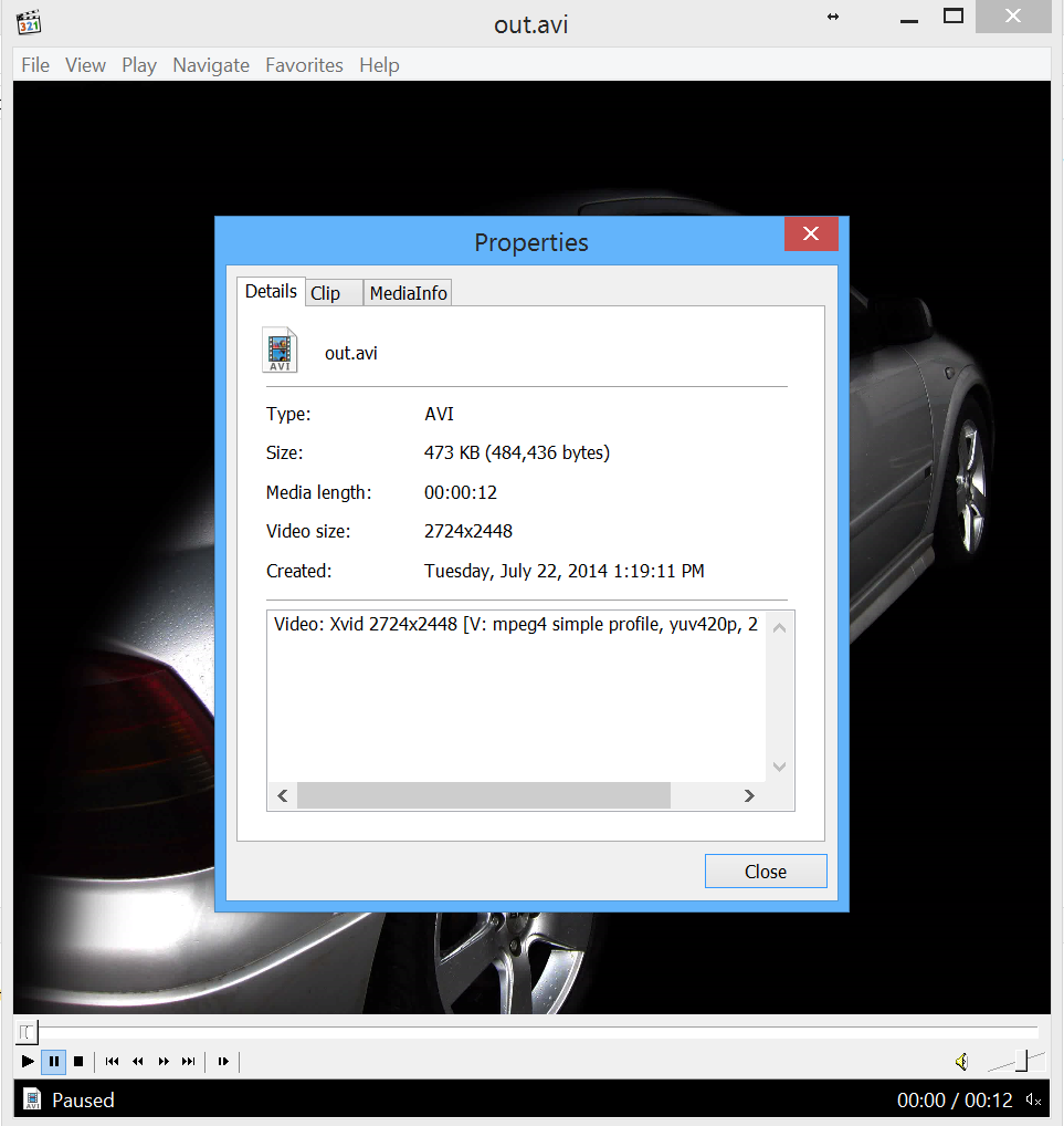

    I am a Windows user, so I used the following command:
    ffmpeg -r 1/3 -i image_%06d.jpg  -filter:v "scale=iw*min(1920/iw\,1080/ih):ih*min(1920/iw\,1080/ih), pad=1920:1080:(1920-iw*min(1920/iw\,1080/ih))/2:(1080-ih*min(1920/iw\,1080/ih))/2" -vf fps=1 out.mp4 -c:v libxvid -pix_fmt yuv420p out.avi
    The output video contains only few frames. They seem to have approximately correct aspect ratio, but ffmpeg skipped all photos with "tricky" aspect ratio. I also noticed that the video resolution is not (1920x1080), but instead the resolution of the first photo in the input series (2724x2448).

    Input stream #0:0 frame changed from size:2724x2448 fmt:yuvj444p to size:1280x76
    8 fmt:yuvj444p

  13. The dimensions I used for testing:
    All other failed, except 2724x2448 and 1280x768
    And the output video has not a correct resolution.
    Those failed, too. Neither of those images is 16:9.
    Look, life is already tough enough. Can't count how many times I've done this. Use a photo app to make some 1920x1080 black backgrounds. Then resize your pics to fit on that 1920x1080 blackground, paste onto that background and center as well as you can. Save the pics as .png or .bmp, not as compressed .jpg or they'll look like doo-doo if they don't already. Then you'll have a bunch of 1920x1080 picture panels that are the correct frame size and correct image aspect ratio. Then just use something to make a slide show out of the 1920x1080 panels.
    Below are the picture sizes you posted (on the left side of the list). None of them are 16:9 photos. Shown are the sizes you need to expand or reduce the height and width to fit a 1920x1080 frame, but keeping the pic's original aspect ratio. I worked this out on an Excel spreadsheet in about 10 minutes. Note: use even pixel numbers. Don't use frame sizes with odd numbers.
                      original           black     resized
    width height     ratio (w:h)       background    w:h     orientation
    2724   2448  1.13:1                1920x1080  1220x1080  landscape
    1280    768  1.66.1                1920x1080  1800x1080  landscape
    1056    816  ~1.3:1                1920x1080  1404x1080  landscape
     154    556  1:3.6                 1920x1080   300x1080  portrait
    4000   3000  4:3                   1920x1080  1440x1080  landscape
     580    580  1:1                   1920x1080  1080x1080  square
    2592   1944  4:3                   1920x1080  1440x1080  landscape
    2432    544  ~4.5:1                1920x1080  1920x432   landscape
    3264   2448  4:3                   1920x1080  1440x1080  landscape
    2285   1714  ~4:3                  1920x1080  1440x1080  landscape
     338    500  1.48:1 (~4x6 print)   1920x1080   732x1080  portrait
     338    499  1.48:1 (~4x6 print)   1920x1080   732x1080  portrait
    1345   1763  ~1.3:1 (~11x14 print) 1920x1080   832x1080  portrait
    2251   2248  ~1:1                  1920x1080  1080x1080  square
    A picture that's wider than 1920 pixels won't fit. A picture that's taller than 1080 pixels won't fit. A picture that's smaller in every dimension won't fit either (it will, but it won't fill the width or height of the 1920x1080 panel).
    If you want to write some code to auto-test the dimensions of each pic for those sizes and resize as shown and fill out the black border pixels, go ahead. I wouldn't let ffmpeg resize photos. I'd take the time to check each resize for problems. But that's up to you.
