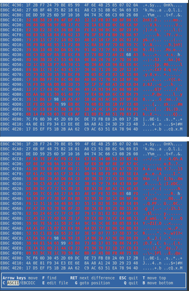

    Here is the difference shown by a hex-edit-comparator (vbindiff):
Name:	Screenshot from 2014-07-21_x.png
    Does anybody know of any other way to check the files? I am absolutely certain that they are copies of the same encoding and should be bit-equivalent so one of those versions must be damaged. I am trying to find out which one to delete and which one to keep.

    @dphirschler my hexeditor screenshot shows a difference with a length of 304 bytes at an Adress 0xE86C4CC0 which translates to ~3718MB though since the address space only allows for 4GB (8 hex digits) and the file is larger than that, this address needs to be interpreted as the result of modulo 4GB. Even so, this proves that the difference is not within the header.
    The difference shown in the vbindiff screenshot is the only difference and both files have exactly the same length.
