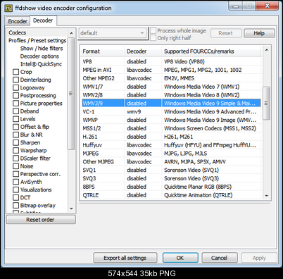

  4. You enable the WMV3 decoder in ffdshow's VFW decoder configuration:
    If you're running 32 bit VirtualDub you need 32 bit ffdshow. If you're running 64 bit VirtualDub you need 64 bit ffdshow.
