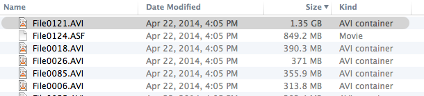

    Hello all,
    Some months ago I posted on this forum about a corrupt SD Card that was given to me to try and retrieve some videos from. We weren't that successful with it initially so we sent it off to a data recovery firm. They were able to retrieve some raw data out of it, including what looks like full sections of AVI files, but nothing will play in VLC. I have tried a few of the repair tools on the site, but haven't had any luck.
    These videos are very important to the family and have some school and social events of their children. Of course they would want to pay for your time and effort if you think a recovery is possible.
    There are only about 4 or 5 events that need recovery and it appears like the events have been snipped and broken up into 10 or 12 files each. In the screenshot you can see some sample files.
    Please let me know if you would like to help or would like to see some of the files as they will be available to share once they finish uploading to Google Drive.
    You may reply to this thread, message me, or send me the contact info of an acquaintance that might be able to assist.
    Thank you and I am hoping for the best here!

  8. The frame corruption is extensive. Just to add to your woes: I can't find a soundtrack in the largest file.

    Tried "File0028.AVI". It has a combined Filesize of 58MB and a reported Video Stream size of 330MB! So either the reporting is off, the file is split into segments (with later segments not showing up with proper headers?), or the file got broken and the remainder is lopped off and gone.
    Not good at all.
    You could try this app: http://grauonline.de/cms2/?page_id=5. The app is "crippleware" where it only repairs the 1st half of any given file (though there are ways around that). If it can work its magic on some of those that DON'T even have thumbnails, I suggest you go ahead and buy it, as it would be worth it to you (or your "owner" client).
