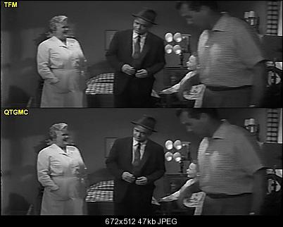

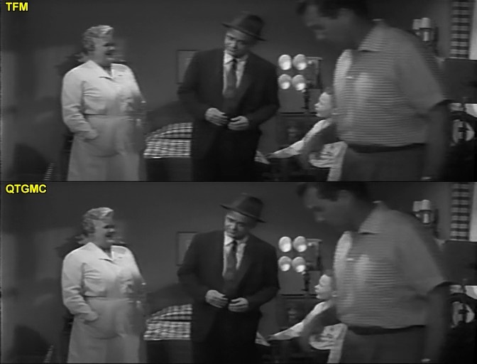

  9. I don't know what you're seeing but this is typical in what I get:
    Frame from the source M2V:
    Result of my script (TFM) and yours (QTGMC):
    TFM keeps almost oll of the horizontal stripes in the man's shirt and doesn't produce any strobing on the bed. QTGMC (from your script in post #36) loses many of the stripes and the lines in the bed are strobing. You can't see the strobing in a single frame but you can see that the details on the bed are different in QTGMC.
