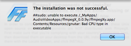

    I took screen shot of the dialog I get - say's something about a bad cpu type. (?)

    The issue here is that the built-in binary gnutar is not compiled for Intel CPUs. It was an oversight when trying to make the installer a Universal Binary (both PPC code and Intel code) around the time of Snow Leopard (Mac OS X 10.6), which excluded standard (but optional) install of the Rosetta automatic code translation. Later versions of Mac OS X do not support Rosetta, thus excluding execution of any PPC code.
    This was corrected for the Lion build and the second revision of the Lion build of ffmpegX.
    The solution for you is to download the latest version, ffmpegX 0.0.9y-Lion r2.
    Jan 2009
    Seaside, Oregon
    Your direction and solution worked fine - thank you.
