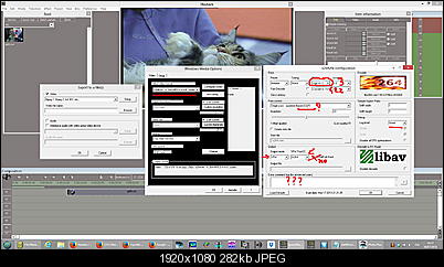

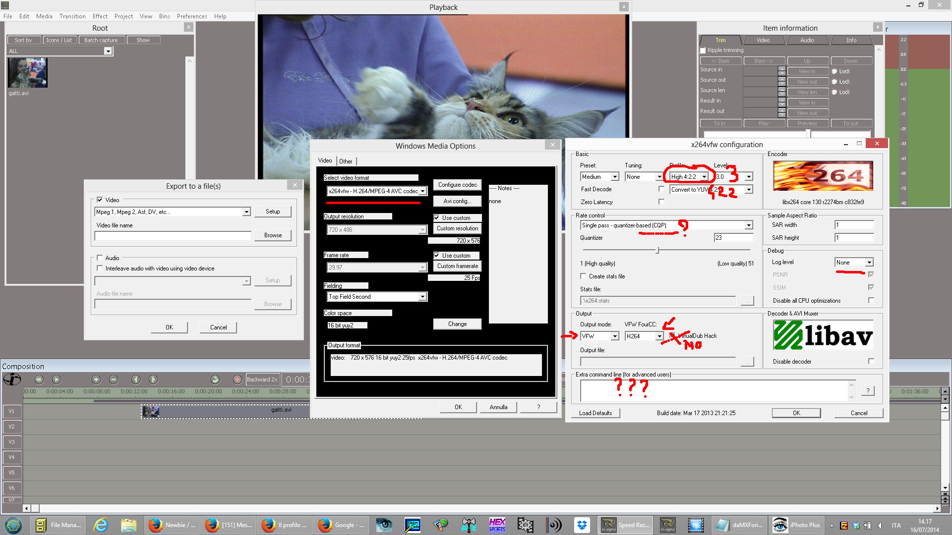

    in this moment I try to use in the SpeedRazor for cats HD 3.11.095.2014-rev.15.32547854IIbeta8547859999 the x264VFW plugin to export in mpeg4
    in the "extra command line" I have to add options so that encoding of x264VFW is similar to the ffmpeg commandline:
    ffmpeg.exe -y -i input.avi -c:v libx264 -profile:v high422 -level:v 3 -g 33 -bf 1 -crf 18 -pix_fmt yuv422p -flags +ildct+ilme -top 1 -x264opts tff=1  -aspect 16:9 out.avi
    please note that I need to export in a mpeg4 in avi, if possibile, this time. Not a .mp4 file
    An I wonder: if the fields "preset tuning profile level" are not congruent with the "extra comman line" option what happens?
    So I how I modify the extracommandline to match the ffmpeg commanline? thanks

  2. extra commandline options override the GUI
    --keyint 33 --bframes 1 --tff --crf 18
    (you can use CRF 18 in the drop down menu as well, instead of CQP , select CRF quality based)
    SAR x:y is for Sample Aspect Ratio (you can think of it as the pixel aspect ratio , or the w:h of the pixels). -aspect 16:9 in ffmpeg is Display Aspect Ratio (DAR)
    Display Aspect Ratio = Frame Aspect Ratio * Sample Aspect Ratio
    e.g
    for 1920x1080
    16/9 = 1920/1080 * 1/1
    So you would enter 1:1 (ie square pixels)
