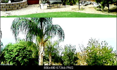

    i took a video with a quadcopter and the bottom quarter of the video is at the top. is there any way i could fix this with editing? ill download any program i need and i have mac and pc so platform isn't an issue. Click image for larger version

  2. You can rearrange it (move the top to the bottom, bottom to top), but there looks to be a strip of missing data in the middle
    What is the actual format of the video ? What does mediainfo (view=>text) say about the video file ? Perhaps the program you are using to view and take screenshots isn't decoding it correctly
    https://www.videohelp.com/tools/MediaInfo

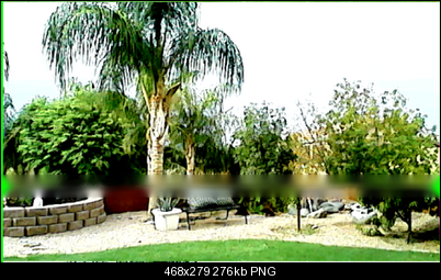

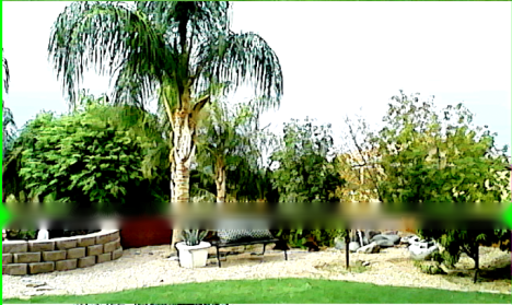

  3. Using AviUtl, make some rearrangement and using mtDeSub plugin(analogous to InpaintFunc in Avisynth), can create something like this:
Name:	Screen Shot 2014-07-15 at 5.17.57 PM-Fix1.png
    but it may be better to check your equipment and re-take the video
