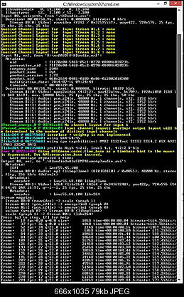

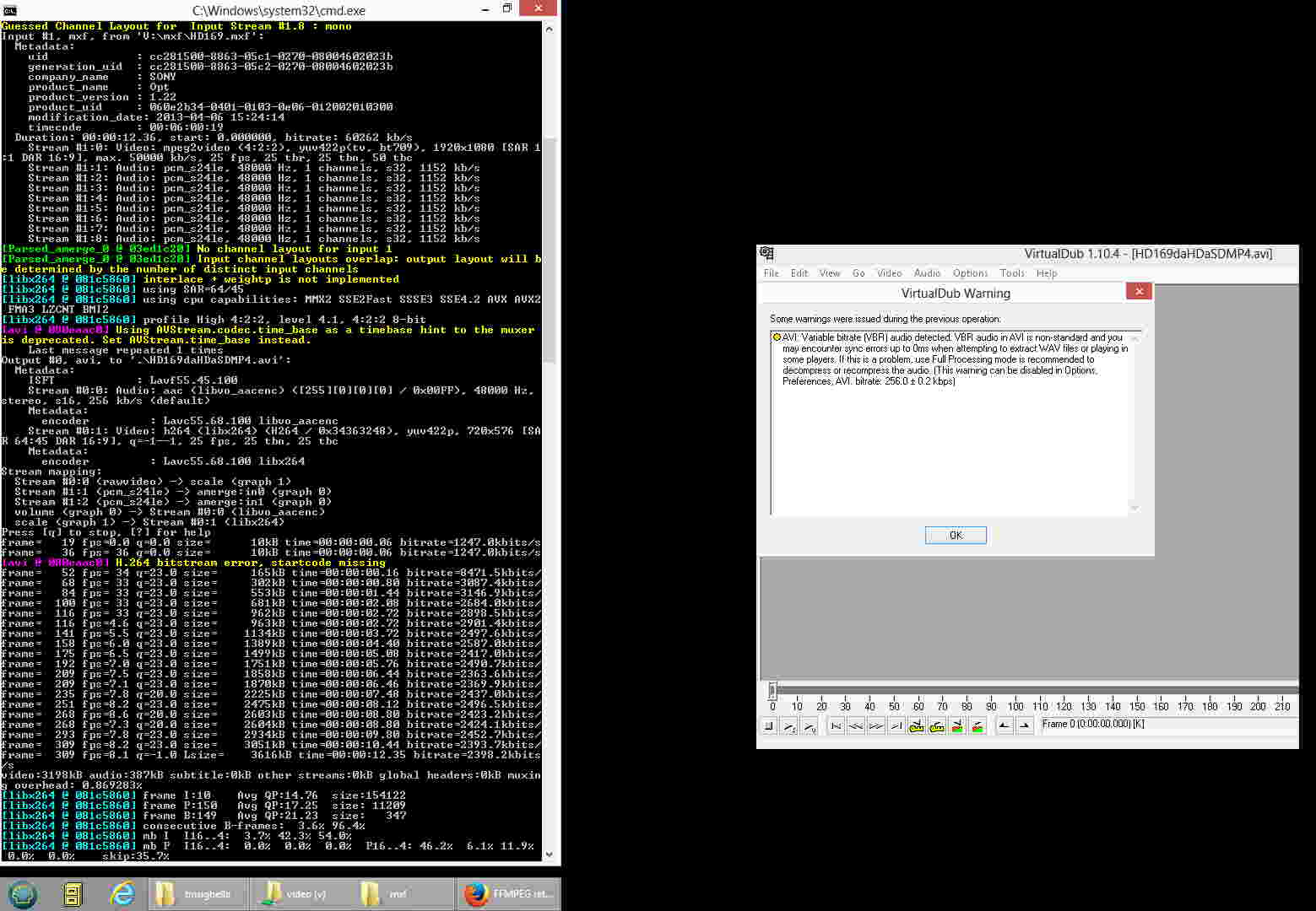

  2. this the ffmpeg error:
    processing source file V:\micio\gatto.mxf
    ffmpeg version N-64405-g7d179b1 Copyright (c) 2000-2014 the FFmpeg developers
    built on Jul 3 2014 22:02:04 with gcc 4.8.3 (GCC)
    configuration: --enable-gpl --enable-version3 --disable-w32threads --enable-av
    isynth --enable-bzlib --enable-fontconfig --enable-frei0r --enable-gnutls --enab
    le-iconv --enable-libass --enable-libbluray --enable-libcaca --enable-libfreetyp
    e --enable-libgme --enable-libgsm --enable-libilbc --enable-libmodplug --enable-
    libmp3lame --enable-libopencore-amrnb --enable-libopencore-amrwb --enable-libope
    njpeg --enable-libopus --enable-librtmp --enable-libschroedinger --enable-libsox
    r --enable-libspeex --enable-libtheora --enable-libtwolame --enable-libvidstab -
    -enable-libvo-aacenc --enable-libvo-amrwbenc --enable-libvorbis --enable-libvpx
    --enable-libwavpack --enable-libwebp --enable-libx264 --enable-libx265 --enable-
    libxavs --enable-libxvid --enable-decklink --enable-zlib
    libavutil 52. 90.101 / 52. 90.101
    libavcodec 55. 68.100 / 55. 68.100
    libavformat 55. 45.100 / 55. 45.100
    libavdevice 55. 13.101 / 55. 13.101
    libavfilter 4. 10.100 / 4. 10.100
    libswscale 2. 6.100 / 2. 6.100
    libswresample 0. 19.100 / 0. 19.100
    libpostproc 52. 3.100 / 52. 3.100
    Input #0, avisynth, from '.\gatto.avs':
    Duration: 00:00:11.16, start: 0.000000, bitrate: 0 kb/s
    Stream #0:0: Video: rawvideo (YUY2 / 0x32595559), yuyv422, 720x576, 25 fps,
    25 tbr, 25 tbn, 25 tbc
    Guessed Channel Layout for Input Stream #1.1 : mono
    Guessed Channel Layout for Input Stream #1.2 : mono
    Guessed Channel Layout for Input Stream #1.3 : mono
    Guessed Channel Layout for Input Stream #1.4 : mono
    Guessed Channel Layout for Input Stream #1.5 : mono
    Guessed Channel Layout for Input Stream #1.6 : mono
    Guessed Channel Layout for Input Stream #1.7 : mono
    Guessed Channel Layout for Input Stream #1.8 : mono
    Input #1, mxf, from 'V:\micio\gatto.mxf':
    Metadata:
    uid : 24271e00-2968-05c1-0270-08004602023b
    generation_uid : 24271e00-2968-05c2-0270-08004602023b
    company_name : SONY
    product_name : Opt
    product_version : 1.22
    product_uid : 060e2b34-0401-0103-0e06-012002010300
    modification_date: 2014-06-21 21:57:11
    timecode : 01:28:04:05
    Duration: 00:00:11.16, start: 0.000000, bitrate: 60493 kb/s
    Stream #1:0: Video: mpeg2video (4:2:2), yuv422p(tv, bt709), 1920x1080 [SAR 1
    :1 DAR 16:9], max. 50000 kb/s, 25 fps, 25 tbr, 25 tbn, 50 tbc
    Stream #1:1: Audio: pcm_s24le, 48000 Hz, 1 channels, s32, 1152 kb/s
    Stream #1:2: Audio: pcm_s24le, 48000 Hz, 1 channels, s32, 1152 kb/s
    Stream #1:3: Audio: pcm_s24le, 48000 Hz, 1 channels, s32, 1152 kb/s
    Stream #1:4: Audio: pcm_s24le, 48000 Hz, 1 channels, s32, 1152 kb/s
    Stream #1:5: Audio: pcm_s24le, 48000 Hz, 1 channels, s32, 1152 kb/s
    Stream #1:6: Audio: pcm_s24le, 48000 Hz, 1 channels, s32, 1152 kb/s

  17. For kindness: I should have another question
    Return to the HD-->SD conversion:
    for example with this as source
    https://www.dropbox.com/s/7nx4i1dcql02wmv/HD169.MXF
    I try to encode it in SD-MP4 but in avi container, with the commandline tha assume as video source the .avs (all is well working when output container is .mp4)
    ffmpeg.exe -y -i "%2" -i "%CD%\%~n1.mxf" -filter_complex "[1:1] [1:2] amerge,volume=2" -c:v libx264 -profile:v high422 -level:v 4.1 -g 33 -bf 1 -crf 18 -flags +ildct+ilme -top 1 -x264opts tff=1:colorprim=bt709:transfer=bt709:colormatrix=bt709 -filter_complex scale=interl=1:in_range=tv:out_range=tv -pix_fmt yuv422p -aspect 16:9 -r 25 -c:a libvo_aacenc -b:a 256k workFolder%\%~n1daHDaSDMP4.avi
    encoding is semi "ok" but ffmpeg report this "bitstream error startcode missing"
    If I try open the .avi in virtualdub is returns the audio error
    and when I open the .avi but firt frame is black (decoder is VFW "vidc.h264=x264vfw.dll, confirmed also in virtualdub File Information)
    and for second: to correctly open a mpeg in avi file in virtualdub, what can I use?
    I have installed the FFMPEGInputDriver 0.8.1.4 plugin but it seems act for .mp4 and not for .avi file although it's a mpeg in avi, can I configure it to open also mpeg in avi files?
  18. stuffing H.264&aac inside an .avi container is a bad idea, since afaik there is no splitter which can really handle aac inside an .avi container properly (=seeking&normal playback does work).
  19. Originally Posted by Selur View Post
    mm I understand, what is the best alternative? I'm tryed with mp3 lame and seems the ffmpeg don't return the "bitstream error startcode missing"
    but when I open the out.avi in virtualdub I get the same error:
    Is there a way to resolve?
    Mediainfo says the audio part is CBR, but for VirtualDub is VBR: who have reason?

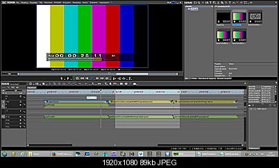

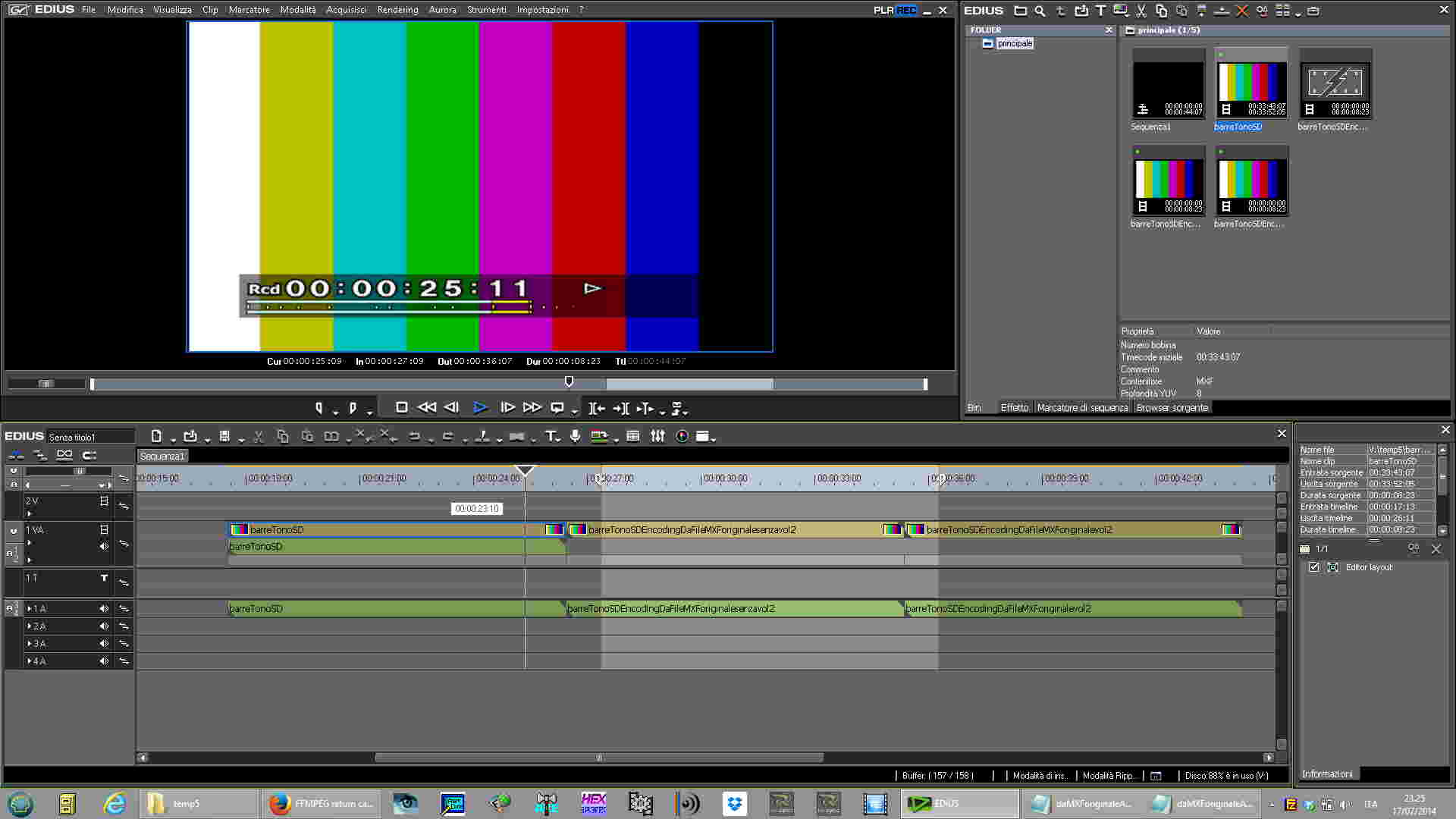

  26. I have do many catproofs:
    seems to me that they are identical, and both are functional
    the important things is this: by default seems to me I have to set the volume=2 to have the same levels of the original mxf
    supposing this is the commanline:
    ffmpeg.exe -y -i barsSD.mxf -af "pan=stereo:c0=c0:c1=c1,volume=2" -vf crop=720:576:0:32,scale=interl=1:in_range=tv:out_range=tv -pix_fmt yuv422p -c:v libx264 -profile:v high422 -level:v 3 -g 33 -bf 1 -crf 18 -flags +ilme+ildct -top 1 -x264opts tff=1 -c:a libvo_aacenc -b: 256k -aspect 16:9 out.mp4
    where barsSD.mxf is the original recording of the bars and EBUL audio levels, and is this
    https://www.dropbox.com/s/41k459jnbzjujt7/barsSD.MXF
    I have tested the audio levels on edius, and it was a very very very difficult test because my cats get nervous when I open
    erdiuscatagainst nle^^
