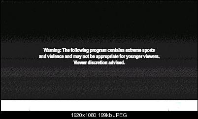

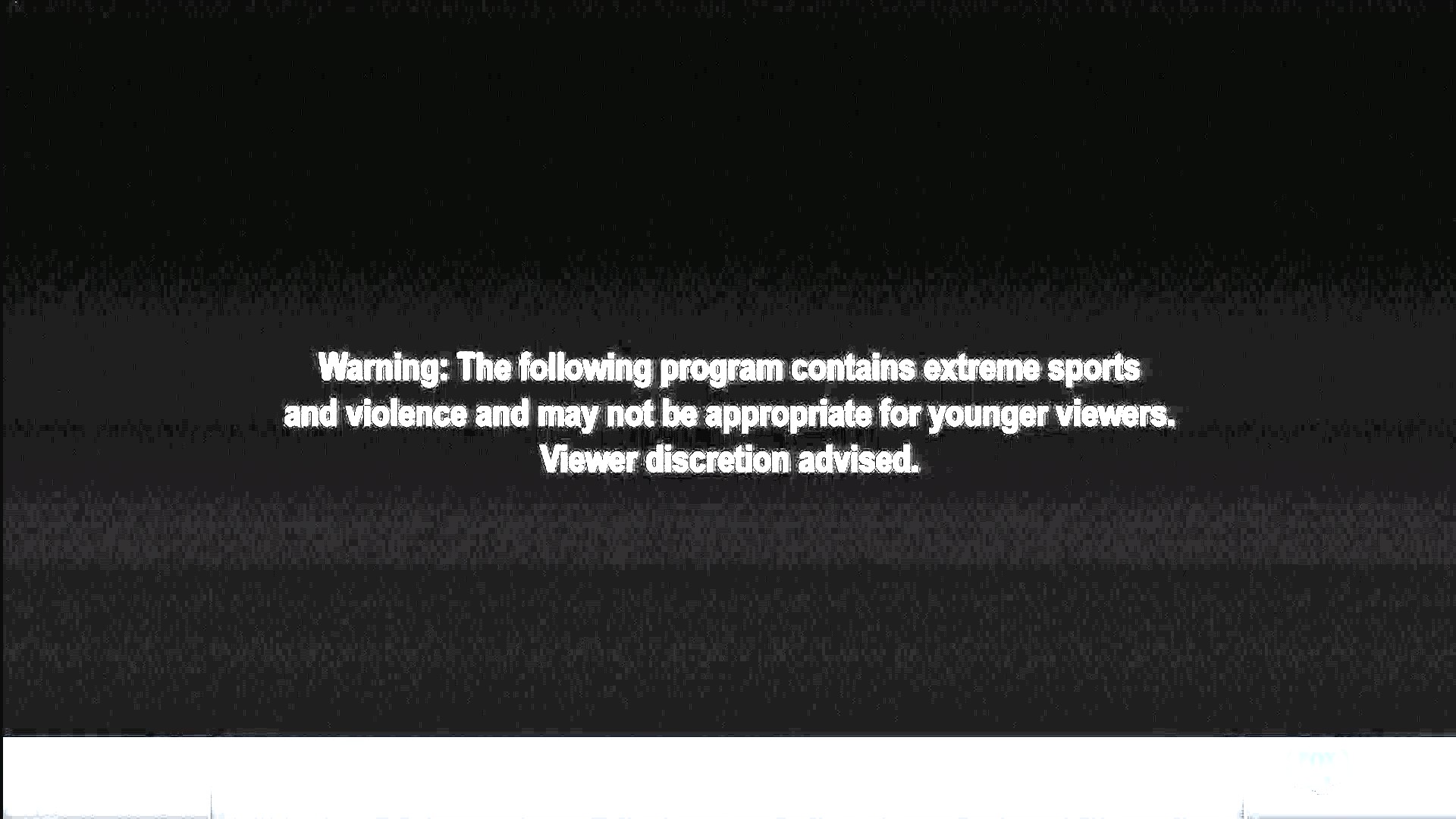

    I use a Hauppauge HD PVR 1212 to capture video and I have the component cable attached to the cable box. I'm 99% sure it's not the HD PVR. I think it's electromagnetic waves in my electric circuit or maybe in the coaxial cable line. Is there anything I can do to remove the static waves. These waves are almost unnoticeable during most shows but when the screen is a solid color like in the example they are very present in my mind. Any help would be appreciated. Thanks!
    SCREENS
    Here are a few screens and I highlighted the wave as it moves up for those who don't want to download the sample.

  3. Those are not red lines, I used paint to highlight the wave in the images, in the video you can see an electromagnetic wave go from bottom to top.

    Those look like low frequency hum bars due to poor signal grounding. When you say that you're pretty sure it doesn't come from the HD PVR, I guess you mean that you see this disturbance through your normal viewing on all channels through other TV inputs from your cable box, and not just through the PVR or its component pass-thru. Your TV must be set to Volcano Display Mode to see something that dark anyway.
    To check your incoming cable for bad grounding or other noise, or to check the box itself, get with your cable provider. If they find no problems in your cable or your box, it's time to look around for a hookup to a power conditioning unit -- this often happens when your TV/audio stuff is plugged into power outlets shared with refrigerators, air conditioners, etc.. It can also be caused by cheap "surge protectors", which is what most people think they're getting when they spend less than a hundred bucks USD on those things.

  8. After a gigantic gain (allowing the brighter parts of the picture blow out):
    Could be in the source, bad grounding, HDPVR issue.

    It called Ground Loop which lee a common problem with Cable system so what you need do is get a ground loop isolator like a Viewsonics VSIS-EU or Jensen VRD-1FF but if your still have that same problem after words then you get a Video Isolators from Jensen Transformers

  12. Thanks for the input, I'll try some of your remedies. I did find out that the wiring in my building is like 25 years old. When I fist moved in the cable would digitize all the time so I replaced the wiring with new cable but I may not have grounded it properly. I do use a UPS that most defiantly weighs more than a boot lol. Thanks for the help.
  13. Originally Posted by SHS View Post
    I bought Viewsonics VSIS-EU and instantly fixed my problem! Thanks so much SHS!
