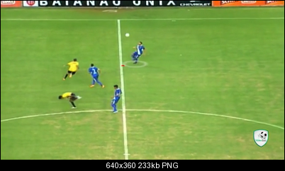

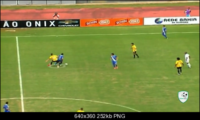

  1. Compare Scott's example to the soccer clip. See how the ring transsects through the player(s)' leg ? . That' s just a simple overlay
    Yeah, they mickeymoused it, and nobody probably noticed, except editors.

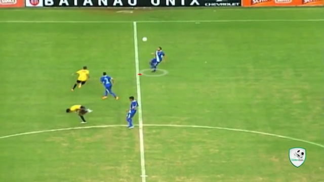

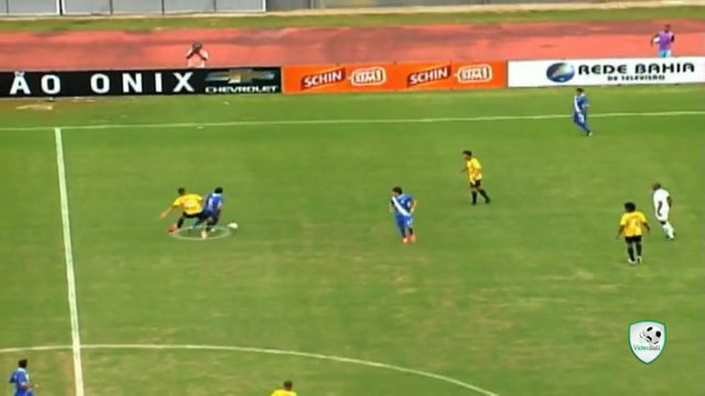

  20. Member racer-x's Avatar
    Mar 2003
    3rd Rock from the Sun
    This one is a little better. It's hard to do with a crappy source video file like this one.

    Pretty much what Scott said. I used 3 layers. Bottom layer= background. 2nd layer= graphic in screen mode and opacity adjusted. Top layer= background + Chroma Key green grass.

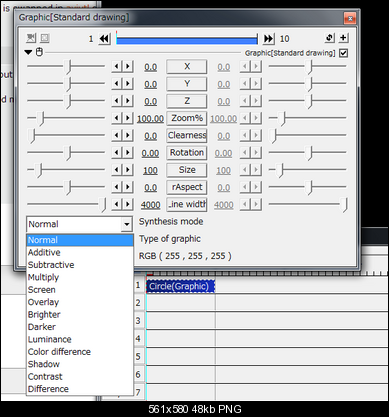

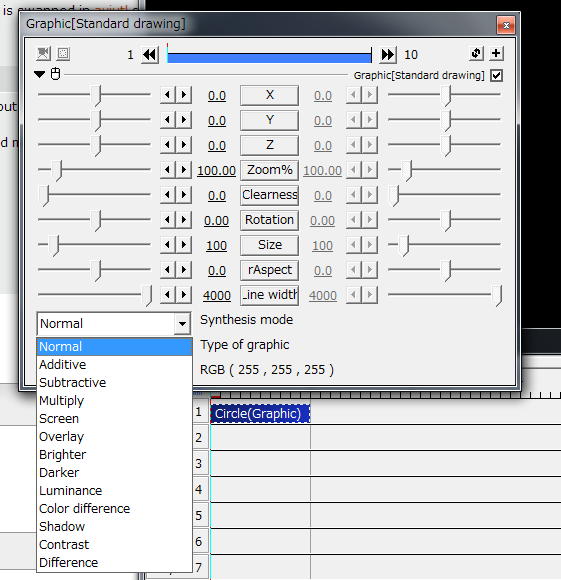

  28. Blend mode(labeled as "Synthesis mode"):
    [Layer 1] Original video (BG/Bottom layer)
    [Layer 2] Clown
    [Layer 3] People only (chroma-keyed the green grass)
