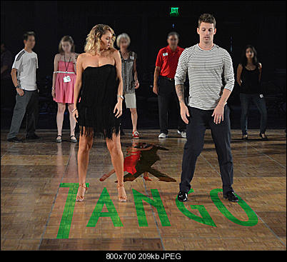

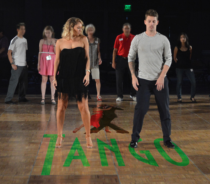

  27. Member Cornucopia's Avatar
    It's not the compositing that is hard here, it is the chromakeying & the tracking (which is why they needed to do all that pre-production work to make the perspective and key color swatches exact).
    Still example via Photoshop from something I recently did (the shoot, not the graphic): Click image for larger version
    In the example, there are 3 layers.
    1. Bottom is standard background layer
    2. Middle is alpha graphic with 3D perspective applied and Overlay Blend mode used (~85% opacity)
    3. Top is background layer but with floor/court/grass/base chromakeyed out
    P.S. And YES, that is Kym Johnson!

    That looks great Scott. The floor has a minimum of two different colors, how did you manage to key both out at the same time and stay clean? Could you post a couple of seconds of motion scene to see it in action?
    Budwzr I was just joking because the graphic shape looks like a puddle on the field. You would've had to drink a whole keg to make that....
  29. Keying out 2 colors is not difficult, but the floor's color is close to skin color and that creates problem.
    Tried the "Select>Color Range" in PS CS6 using the image above... I guess quite a bit of manual work is required to get the mask right
  30. Member Cornucopia's Avatar
    It's not all that clean if you look closely. Yes, this particular floor would be a pain to work with. I used ~6 passes adding colors to a garbage mask. The area around her right leg was the worst, contrast-wise. I just had this clip handy, and this was a proof of concept thing anyway.
