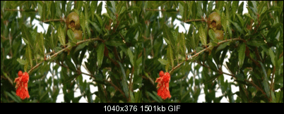

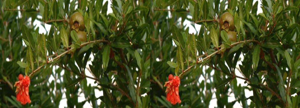

  12. It's terrible job of interlace - It won't pass QC at broadcast. You need to lowpass . This animated gif has been bob deinterlaced. Look at the aliasing and buzzing lines on the branches

  15. I already explained tinterlace is bad without low passing. See the animated gif. (The left was -vf interlace, right was -vf tinterlace) . Remember, sharp=bad for interlaced content. It's a tradeoff. If you want to retain details, sharpness , then you have to live with the aliasing and twittering lines
    For ffmpeg, I would use -vf interlace instead of -vf tinterlace, because it low passes by default. In motion there is a lot less aliasing and buzzing lines. tinterlace does have a low pass mode, but then image is softer. Recall you wanted to use different resizer (lanczos), because image was soft, blurry ? That's because of the low passing and soft resize. You need it slightly blurry for interlaced SD.
    And for your "test" shots, you need motion, like a camera pan. A static shot won't reveal as many problems
