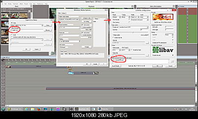

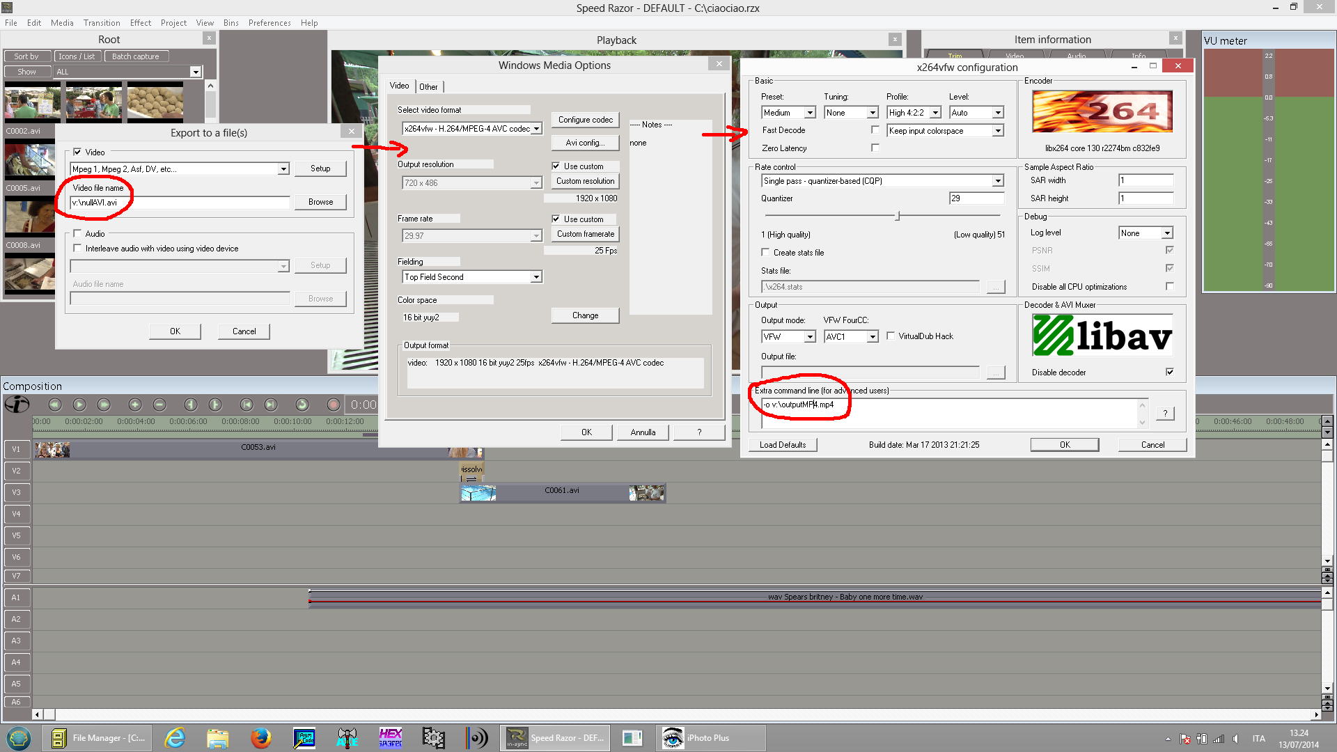

    poison a kindess:
    1) can I set the x264vfw to write interlaced .mp4 file? semms to me by the mediainfo that .mp4 is progressive
    2) I my beautiful dinosaur Spee Razor 5.51 in sync super professional NLE editor (for cats) I have select the "Mpeg 1, Mpeg2, Asf, DV, etc..." plugin that recall a the list of VFW codec installed on the system. Exist a way to pass the output stream of the NLE directly to ffmpeg, as and external encoder?
    3) do you know a AAC encoder VFW that I can install on window 8?
    thanks

  7. Member racer-x's Avatar
    Mar 2003
    3rd Rock from the Sun
    Have you tried this command? You should probably place it first.
    --tff

    Anyway, this seams to work on the VFW encoder when I tested it out. Make sure you have the quotes for the "output path".
    --tff -o "C:\Jnk\out.mp4"

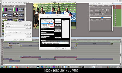

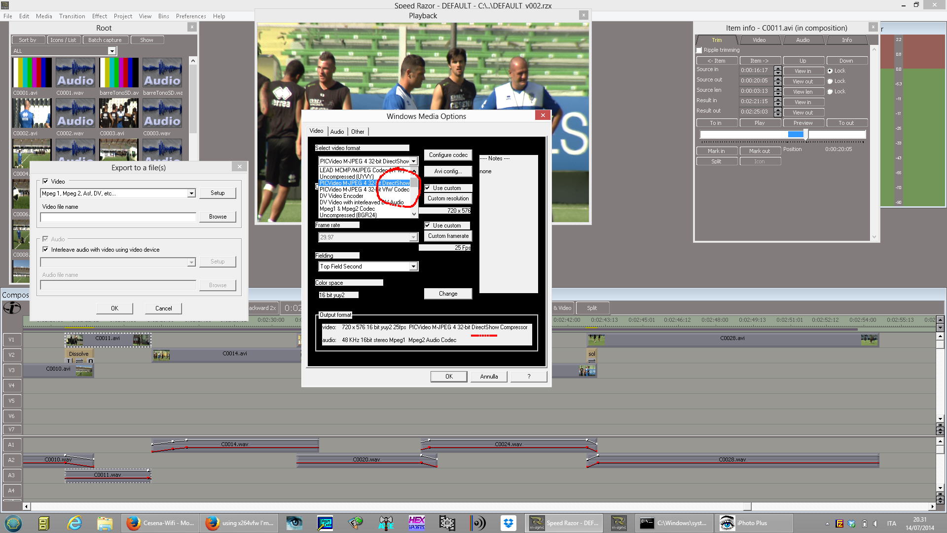

  20. but from the NLE I cannot use ffmpeg, the "problem" is that if I want use virtualdub I 'm force to export in uncompressed - > import in virtualddub and then export in the final format
    But for example, using the x264 VFW codec I can directly export in MP4.
    However if I don't mistake, my NLE can "view" and manage directshow codec: for example the PIC mjpeg codec, when installed, have 1 codec VFW and 1 codec direcshow. My nle recognize both. My problem is that I cannot find a codec (I think directshow only) that allow me to export in MXF xdcamhd422 or MXF imx-D10
    Speed Razor can also export natively in mpeg2... but does not have the internal decoder
