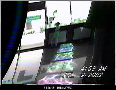

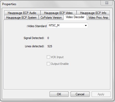

    I’ve just purchased the happauge USB-live 2 device to convert my analog Hi8 tapes to digital. I am using a top of the line Sony E-VS5000 dedicated hi8 tape player and I’ve connected it to the usblive2 using s-video. I have installed the latest WinTv 7 software along with the latest drivers. The results of my captures are not good. There is too much horizontal flicker/tearing on the video indicating horizontal sync problem. It seems to happen almost ever 10-20 seconds of video. I have ruled out the VCR as it does not happen with it is connected to a TV and I’ve ruled out the tapes, they all behaving similarly.
    I also tried another capture program and the problem is that a ‘VCR Input’ option appears to not be allowed by happauge drivers. I used to have an piece of crap old capture card (pinnacle 500 usb) that had this option which actually fixed this flicker and didn't have an issue. Why is it inaccessible with happauge, and what can I do to fix this?
    Take a look as an example:

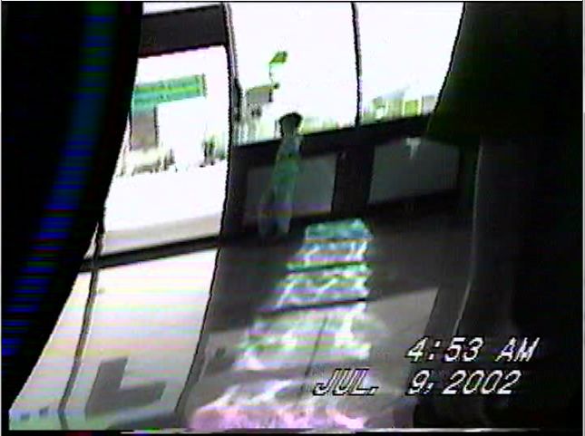

    This is a still shot of approximately what is happening to the image:

    What version of Windows is installed on your capture PC? Sometimes options in capture drivers that are deactivated in later versions of Windows become available using Windows XP, but not always. The feature you want to use may never have been implemented or is unsupported by the hardware.

    I use a dedicated WinXP capture box, and I can confirm that this feature - "VCR Input" - is grayed out in VirtualDub with the USB-Live2. Should install and try it on my Win7 machine, but too lazy right now, and wouldn't think otherwise in any change. But will do it if request is strong enough. Besides, this "VCR Input" option has had no difference or benefit in my tests. (Unless I'm missing something significant, someone please enlighten me. )
    Your problem is not this option, or lack thereof, and not your capture device, or even your VCR (although some VCRs can be worse than others with this, namely the high-end JVCs, and can vary per tape...).
    You need proper line correction. This problem can happen quite frequently when tape flaws collide with digital transfer. As you can see, VHS (or similar) was never intended to be a digital format. (I hate VHS. I always did.)
    As Usually Quiet touched upon, get yourself one of those DvD recorders that do this line correction with an internal line-based TBC using it in pass-through. (Who cares really if they do anything else, or whether they can still record or not).

    It appears it's not offered by Hauppauge via hardware architecture or software drivers. But I do notice it offered in Empiatech em2XXX-based devices, like the ATI 600 USB, or ezcap.tv, or StarTech.
    But I have seen no benefit, or even anything counter-productive, to using such a feature (talking about VirtualDub). At least not with any of my devices.

  11. I just did a test and can confirm the VCR input option is still greyed out on XP. Oh well!

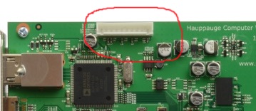

    The "VCR Input" option checkbox is for a front/rear panel A/V input option mostly for PVR/HVR/Colossus model that have white 10/13pin A/V header but any case that standard filter that Hauppauge using with all there device.

    Well, it's grayed out on the USB-Live2, so it must be enabled by default then given that it's a rather recent product.
    I'm just curious, if you or anybody knows, what this feature enabled would do with a device like the ATI 600 USB, or similar devices capturing S/D analog video. I personally have seen no difference.

  18. A lot of video capture chips include a line TBC function -- but few drivers enable it.
    As I said it for this only this in below picture so it doesn't matter if it a recent product

    The only capture screenshot in this thread is from a capture made using a Hauppauge USB Live 2, so maybe you should just stop typing now before you make an even bigger a fool of yourself.
