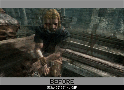

    Is there are way to remove or at least decrease the frame blending effect caused by a previously rendered video with smart Resampling enabled in Sony Vegas?
  2. In theory it's possible to improve , but results depends heavily on the cadence of the blends, the exact type of blend, and amount of "good" frames are present
    There are various deblend scripts used in avisynth, unblend, deblend, c deblend, removeblend, many others . Some are geared towards specific types of blends
