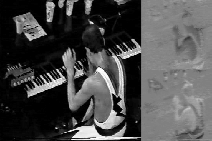

    There's some pretty random stuff going on in the colour channels. Here are the Y, U and V channels after SeparateFields():
    The luma channel (big image) is pretty consistent, though it seems to have some kind of combing left even though we are supposed to be looking at a single field only.

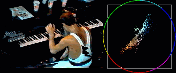

    The chroma channels however are all over the place. The colour information is rolling around, maybe someone here can recognise what the cause is and properly reverse it. Here's a look with Histogram(mode="Color2"):

    Here's a very quick brute force attempt at stabilising the colours so that the clip is at least watchable. With stage lighting like that, maybe it's not too important to get the colours exactly right anyway.
    Source(...)
    ChromaShift(-4)
    SeparateFields()
    MergeChroma(Blur(0,1), TemporalMedian(7))
    Interleave(SelectEven(),SelectOdd())
    Weave()
