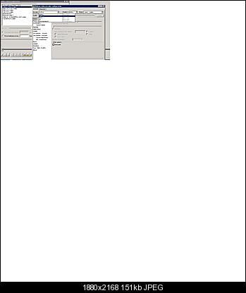

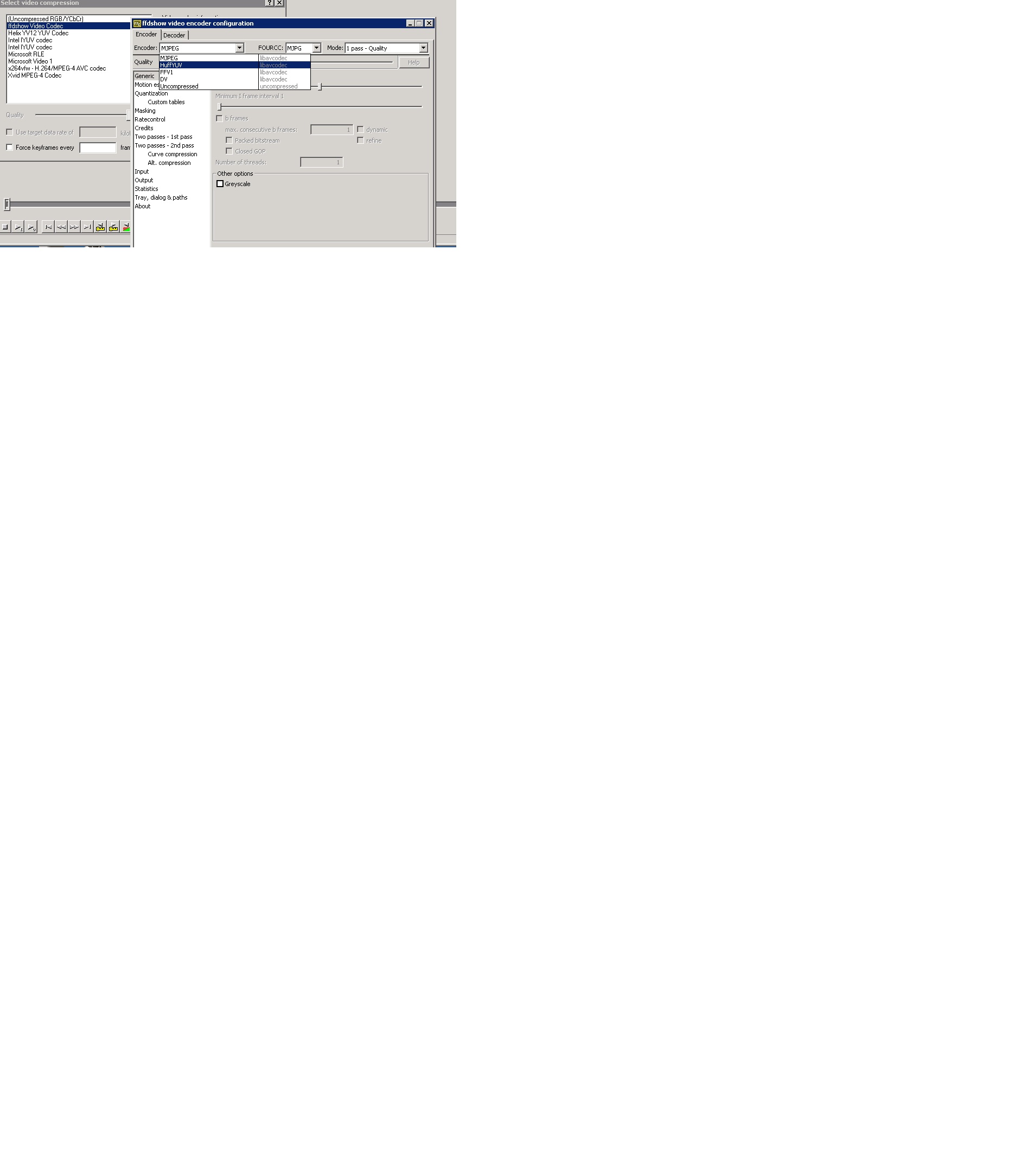

    codec xvid missing from decoder
    please help me

  2. Member DB83's Avatar
    Jul 2007
    It's on the bottom of the first pane.

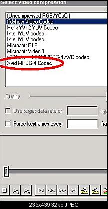

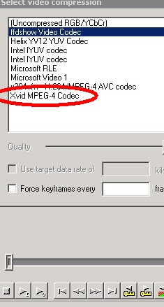

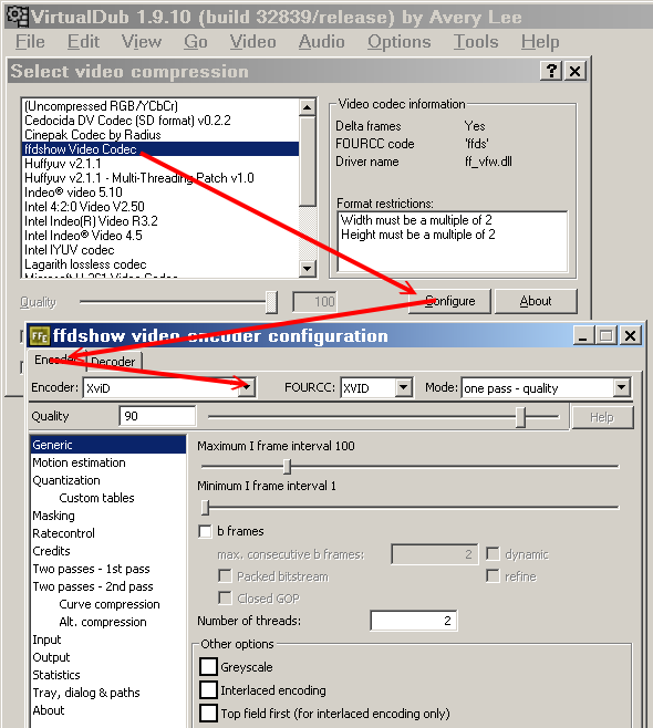

  4. Most encoders were removed from ffdshow a few years back. You'll need to find a old version if you want to use Xvid in ffdshow. But why bother? You already have the Xvid codec installed and can use it directly.

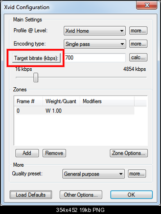

    i want compress with bitrate
  6. Xvid lets you select the bitrate.
    Feb 2012
    egypt
    how?

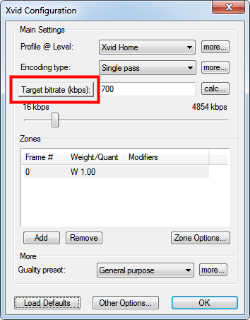

  8. If the indicated button reads "Target Quantizer" press it and it will change to "Target Bitrate":
    Feb 2012
    egypt
    [Attachment 26288 - Click to enlarge]
    thanks
