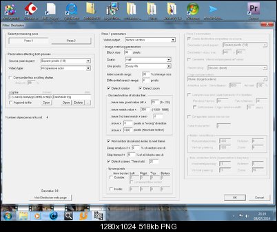

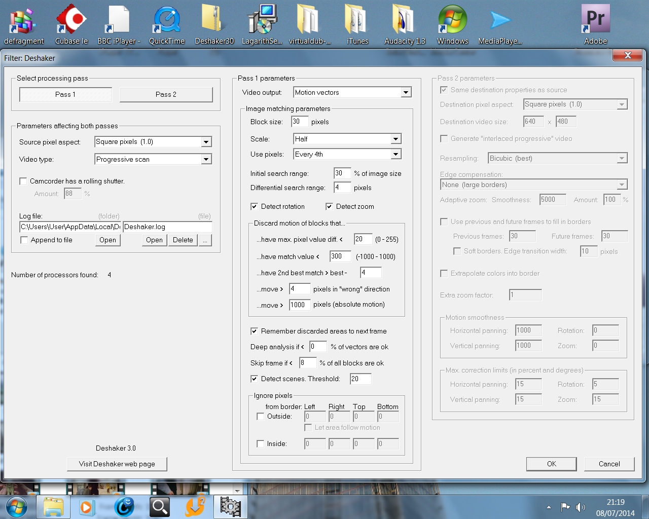

    No. Here's a screenshotClick image for larger version
  8. Is there any data in the log file?
    Change some of the pass 2 settings, any effect to the preview ?
