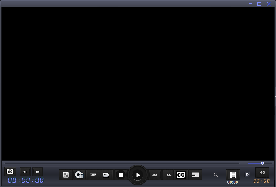

  1. Senior Member c627627's Avatar
    Kansas
    Download Skin v1.3: DAUM_PotPlayer_SKIN.zip

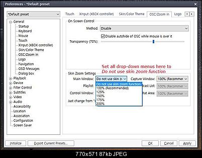

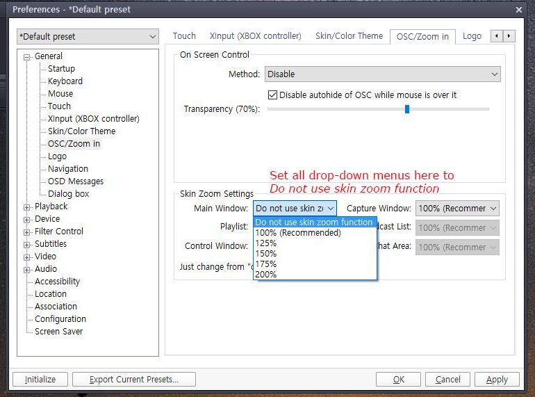

    If your Windows custom sizing options (DPI settings) is above 100% then the new "zoom in skin" feature in v1.6.6.x breaks the clear display of some custom skins, unless you go to
    Settings > [under General] OSC/Zoom in > Skin Zoom Settings > Set every option to Do not use skin zoom function.
Name:	@Do not use skin zoom function2.jpg
    I couldn't find a forum, or a thread let a lone how-to instructions really discussing the actual skin customization process in detail. I had to figure it out from scratch and it took a really long time.
    I have some notes in the attached zipped file on how I did what I did but I really wanted to make a skin that would have large buttons with most frequently used commands (for me) and not have the minimalistic look at all that a lot of other skins have and also not have microscopic tiny buttons that virtually all other skins have. Instead I opted for things like a large mute button - it comes in handy.
    So... I really wanted to avoid going through a jungle of Menus > Submenus.
    For example:
    • When you take pictures with your phone, sometimes your pictures are landscape and sometimes portrait orientation. Then, in your wisdom, you think you can record video automatically in landscape or portrait and video gets recorded flipped at a 90 degree angle. Well how about a Rotate video single click button?
    • Sometimes you watch something and you go, 'What did he say?' - well how about a Closed Captioning single click button so you can just quickly turn captioning ON/OFF?
    • How about a quick screenshot of anything with a single click?
    • How about a LARGE mute button?
    • How about a single click button that takes you to the menu of the DVD you're watching in case you're watching a multi-episode DVD?
    • How about separate Open DVD / Open file buttons?
    It took a long time to make all that.
    Freeware player download:
    https://www.videohelp.com/tools/PotPlayer
    For this skin to work, copy the .dsf skin to
    C:\Program Files\DAUM\PotPlayer\Skins
    and then right click on the player > Skins > to select a different Skin.
    Right click on player > Preferences >
    Click on + next to General > Startup > Window size: Custom size: 900 x 506
    and
    Playback > Default window size: Video output size x 1.5
    [If you select Fit to video aspect ratio, then 720x480 videos will start playing at a window size that cannot display all custom buttons of custom skins with large buttons.]
    [Since the skin has large buttons, initial window size has to be set larger like that.]
    DAUM_PotPlayer_INFO.zip

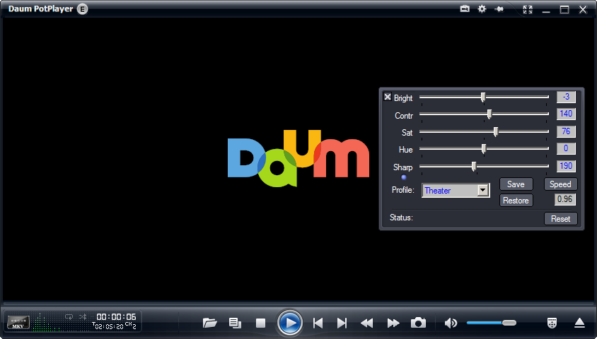

    Good job with your customization. In case anyone's interested, here's a pic of the old TMT3 skin that I prefer the most (last seen by me in 1.5.28025). It lacks the new control panel but is easy to include one from another skin. I've customized a few button functions and made a new Daum logo. Also shown is my separate Colour Profiler app (incl precise speed controller), it's not skinnable but roughly matches the TMT3 theme.

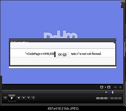

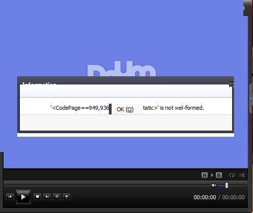

    i can't apply this skin on potplayer version 1.5.44407..... plz help i get this error:

    I have old Windows 2000 machines which use old PotPlayer versions so I made this skin for them and it will help you too because it will work on your old version of Daum PotPlayer as well. It has no zoom feature though and it has a Windowed frame:

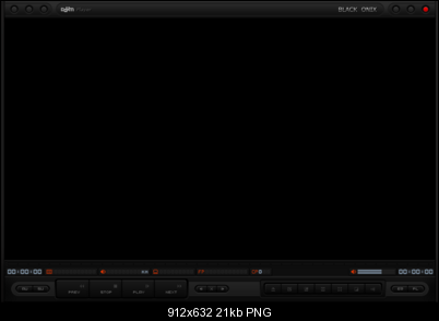

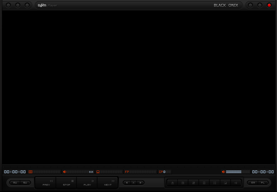

    update skin Black Onix 0.4.9.8.demo
    https://forum.videohelp.com/attachment.php?attachmentid=27742&stc=1&d=1411902702
  15. Senior Member c627627's Avatar
    Kansas
    That's a really interesting one, thanks. My favorite part of it are the buttons, very nice!
    Can you translate tool tips into English?
    The Audio skin is absolutely beautiful but it doesn't work, Black Onix 0.4.9.9 crashes as soon as any mp3 file is opened.
    Rather than gray, I was also looking into the black base frame like black onix but I couldn't find one, it would be nice to use the Black frame with Orange/Red instead of Gray with Blue but it would be too time consuming for me at this point, maybe some day in the far future
    [Attachment 26988 - Click to enlarge]
    I have installed new 1.6 beta version and there isn't old skin (like on that pic). Could somebody please upload that skin here?
  17. Senior Member c627627's Avatar
    Kansas
    Hi. To install custom skin on version 1.6, unzip the .zip file from post #1 then for this skin to work, copy the .dsf skin file to
    or
    C:\Program Files (x86)\DAUM\PotPlayer\Skins
    and
    Playback > Default window size: Fit to video aspect ratio.
