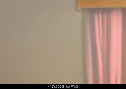

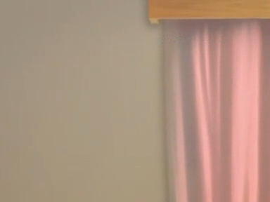

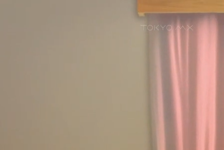

  9. A very conspicuous logo, with a logo remover, can look like this:
    https://forum.videohelp.com/threads/360967-AviUtl-video-tutorial?p=2290046&viewfull=1#post2290046
    or use a subtitle remover instead on such opaque logo.
    For pretty transparent logo, removal can be near-perfect, but it may not worth the effort to remove such faint logo anyway.
ID:	26200Name:  De-TokyoMX02.png
