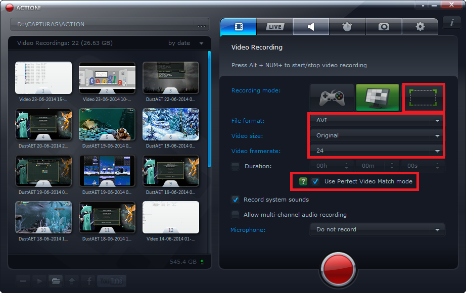

    Originally Posted by rad1701 View Post
    Is there a good piece of software to capture clips direct off a Blu-Ray you would suggest?
    Mirillis Action! or DXTory or Bandicam.
    My preference is Mirillis Action (AVI mode + Perfect sync video)
  6. So, with that Mirillis Action software, it basically screen caps video of what I'm doing on my PC? I do have AnyDVD HD too. Still wondering if an external Blu-Ray player connected through an HDCP stripper and a good capture card might be nice to have to do this too?
