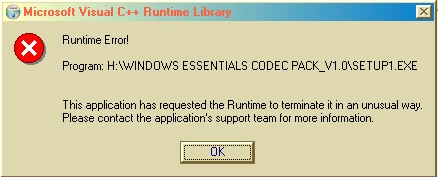

    Yesterday, I came across Windows Essentials Codec Pack_v1.0. It seemed like
    Media Player Classic with a bundle of codecs was the answer to my problem.
    A few seconds into the install a "Runtime Error" box appeared. I managed to
    take a screenshot before the system completely locked up. Please see attached
    jpeg.
    Previous attempts with other players and converters would require adding a DLL
    or some other fix. It didn't help because more problems would follow during or
    after the install.
    Before I quit forever, is there a fix for the runtime error or something else I should
    try?

    Bottom line. Do not use V1. And if V2 does not work then forget it.

    the last official version of that is located at the bottom of this page. http://www.mediacodec.org/download/ see if it's any different from the one you have. you might also try an old video player that might not need external codecs like vlc listed for old windows versions at the bottom of this page. http://www.videolan.org/vlc/download-windows.html
    Feb 2004
    Australia
    If you dont have them add them
    Vb runtime 5
    Vb runtime 6
    Microsoft Visual C++ 2005
    I must have around 90 systems with 98se on them in the shed and use them to teach system assembly cause there cheap and if students kill them it don't matter none.
