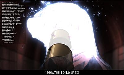

    I have 4 dropped frame when i play video but when i seek across the video the dropped frames are inncreasing
Name:	Bez naslova.jpg
