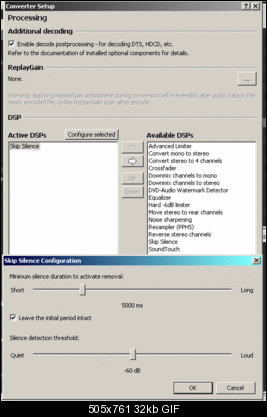

    Foobar2000 does have a "remove silence" DSP though. I have it installed but I can't remember if it's standard component or one I downloaded separately. I'm not sure I've ever used it. It doesn't seem to appear in the components list (or I'm having a dumb day), but it's in my DSP list so it can be added as a DSP when converting in the usual manner. I assume you can add DSPs the same way when you use the "Rip" button? I honestly can't remember, although if I was going to use it I'd probably rip first then use it when converting the ripped files to another format. Have a look to see if you have it.
Name:	skip silenece.gif

    I know about the Foobar "skip silence" DSP, but had read that it can detect silence within tracks (depending on how sensitive you set it) and thus potentially screw things up. EAC has gap-detection, and Nero seems to do it effortlessly as well as allowing you to add gaps of varying length.

    no, AccurateRip doesnt eliminate gaps - I just checked. Foobar still adds the gap to the end. If you use the "Skip slience" DSP, you still get a report that there are inconsistencies in the rips from AccurateRip. So it's kind of pointless, I guess, unless there are no gaps in the original.
