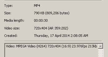

    The aspect ratio displayed next to "Video Size" is the "container" aspect ratio.
    The aspect ratio included in the video stream is the aspect ratio written to the video stream.
    Normally they'd be the same, or very, very, very close to being the same (a player needs to choose which one to obey if they're different).
    If there's no aspect ratio shown (ie 16:9) then the resolution and aspect ratio are one and the same (the video has square pixels).
    Sometimes the container and stream aspect ratios will be a little different..... ie the same aspect ratio might be represented with a slightly different fraction.

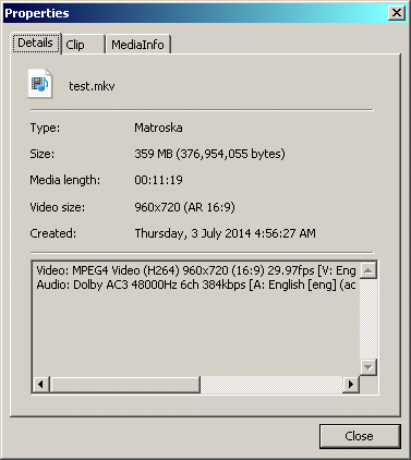

    I'm not 100% why. It may be due to how accurately the information can be written, the program writing/reading the information, or whether it's raining, but even in the above example the difference is very small.

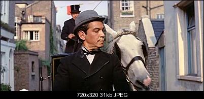

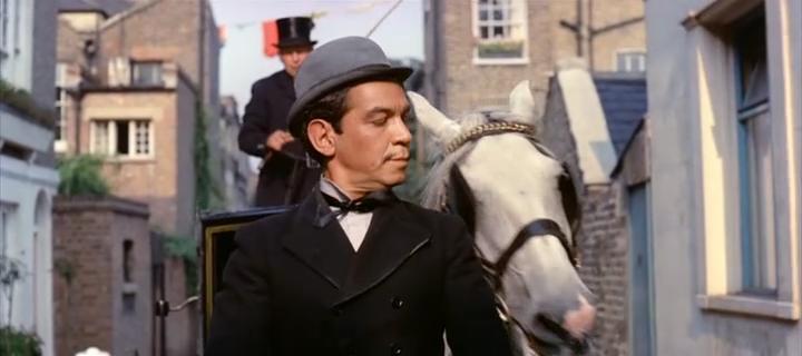

    I give up. I don't know why, but the forum keeps renaming the pics so I seemed to have uploaded the same one twice. In fact when I look at the attachments list there's only one pic listed. I've changed the names and it's still happening. Maybe the forum thinks the second pic is just a copy of the first.
    Yes it seems that's what was happening. I resaved the second pic using slightly different jpg compression which changed the file size a little, and now the forum thinks there's two pics instead of one.
    The first is before muxing. The second is after.
Name:	1 Trimmed.jpg
Name:	2 Trimmed.jpg
