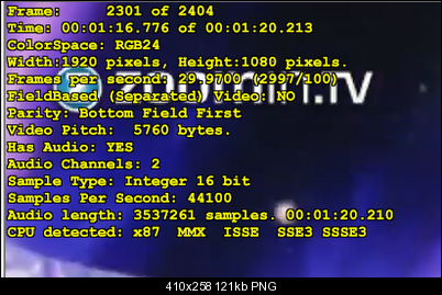

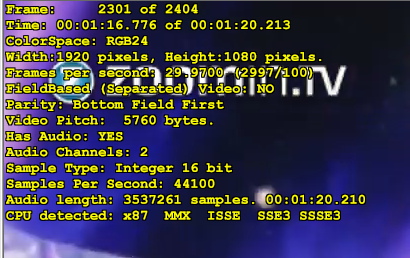

  11. I downloaded _Al_'s batch file and there is nothing there that is changing the sampling rate. That suggests that you are sending 44100 from vegas , and ripbot is upsampling the audio
    Can you do a quick test?
    Start your frameserver as normal
    Create modified avs script
    AVISource("signpost.avi")
    Info()
    Open that in vdub, what does it say on the overlay about sampling rate ?
    Then close ,restart the frameserver , load the "fake" AVI directly into vdub, and look at file=>file information. What does it say about the sampling rate ?
  12. Yes, Ripbot is upscaling the sampling rate, I have no idea why, the project properties in Vegas are set to 48000 even the audio sources are 48000.

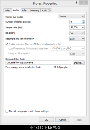

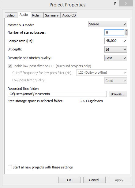

  13. That's the only explanation I can think of, project properties set to 44100 but you said you checked that. Make sure you pushed apply or whatever
    It doesn't matter if write PCM is checked or unchecked, frameserver should serve whatever project properties are set to
  14. Originally Posted by poisondeathray View Post
    Computer life is full of mysteries to unravel or bugs.
Name:	2014-07-05 12_28_04-Project Properties.png
