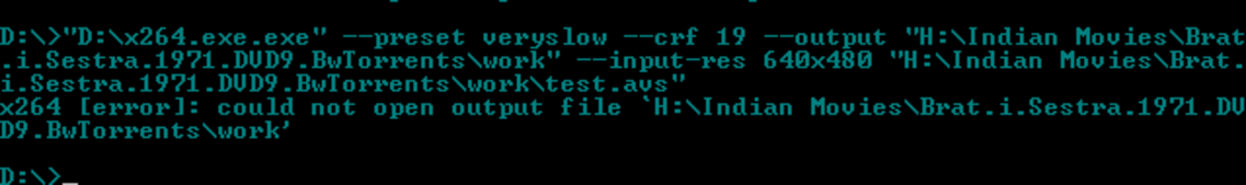

    I'm totally new in command line x264 and got error message like that:
    Thanks in advance.

    Try change the output file to something else.

  3. Member TeNSoR's Avatar
    Mar 2014
    Hungary, Debrecen
    Thanks for reply, but I'm trying to encode dvd by command line x264, I changed the output direction but still the same, any idea?
  4. DECEASED
    Jun 2009
    Heaven
    From x264 --fullhelp|more:
    Outfile type is selected by filename:
     .264 -> Raw bytestream
     .mkv -> Matroska
     .flv -> Flash Video
     .mp4 -> MP4 if compiled with GPAC or L-SMASH support (lsmash)
     .avi -> AVI if compiled with support (yes)
  5. I'm a MEGA Super Moderator Baldrick's Avatar
    So add a filename, \work\file.mkv
  6. Member TeNSoR's Avatar

    I changed the output to "mkv" and gives me "ambiguous option --input"
  7. DECEASED
    Jun 2009
    Heaven
    Hmmmm, only now I have noticed, your command-line is really strange...
    x264.exe.exe <== why the double extension
    And if the input is an AVS file, then the option "--input-res" is clearly unnecessary
  8. Member TeNSoR's Avatar
    Mar 2014
    Hungary, Debrecen
    I changed it but still giving me error

  10. DECEASED
    Jun 2009
    Heaven
    DON'T use the "--input" switch, and see what happens.
    For the notes, I have NEVER used the "--input" switch with x264,
    all I've ever needed is, x264 blah-blah-blah -o path-to\output.264 path-to\input.avs
    P.S.: Ouch, that option simply does not exist, at least up to version 2358
  11. Make your life simple. Extract x264_vs_19.bat from the attached zip file and put it on your Desktop or wherever is convenient. Then you can drag/drop your AVS script (or any media file x264 can open) onto it to make an MKV file in the same folder as the AVS script. The batch file starts x264 at low priority so you can continue using the computer while encoding in the background. Modify that batch file if you want to add other settings.
    If you put the batch file in your SendTo folder you can click on an AVS script and select Send To -> x264_vs_19.bat.
