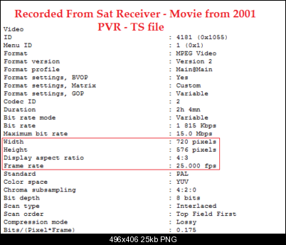

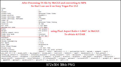

    After recording a TS file, I used MeGUI converting it to MP4 because Vegas can't import TS.

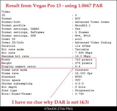

    My problem is that I can't obtain the same output DAR after rendering with Vegas.
    I'll show you the results and hope someone tell me what have gone wrong..

    Well I have never heard of that Vegas could not import a .ts file.
    Well 720*576 is 5:4 but you clearly have not got your ouptut settings correct since your file is now NTSC rather than the PAL input.

    If that is the case, and I still do not believe it, you would have been better to create your mp4 as 768*576 PAR 1:1 which is true 4:3 rather than force it through the DAR which might be fooling Vegas.
    It is?? 720x576 at 25fps seems pretty PAL to me.
  6. Originally Posted by hello_hello View Post
    Hehe, he's referring to the third picture in the OPs opening post which for some odd reason shows the output to be NTSC.
    That was very helpful mate thanks
    Processed again with MeGUI (720x540) 1:1 and everything is ok.

    Even if you couldn't do this, you can change the aspect ratio interpretation in vegas. All 3 must be correct : The clip interpretation AR, the project settings AR, the export settings AR. You messed up one or more of them
