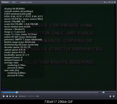

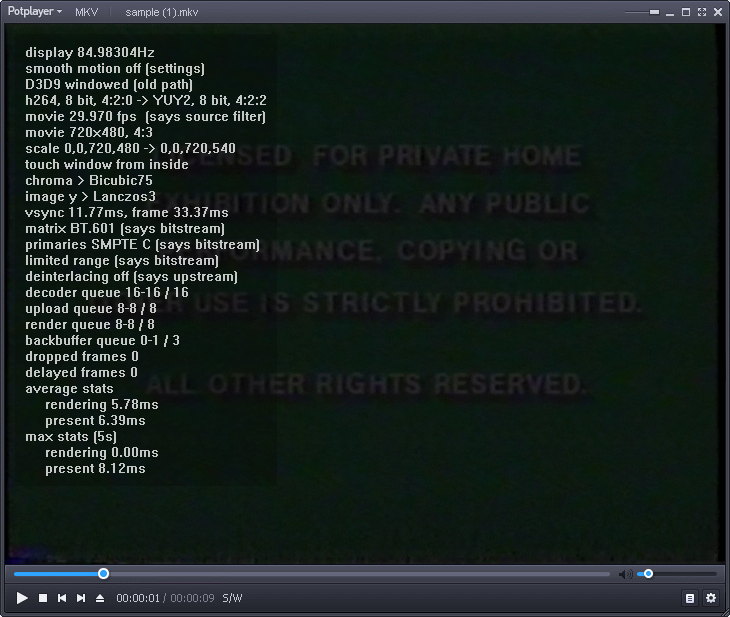

  12. If you select Ctrl+J while a video is playing you'll be provided with statistics regarding playback (use CTRL+J again to disable them). It works for all renderers in MPC-HC, although they supply different information. MadVR is the most informative. CTRL+R should reset statistics such as the dropped frame count. It pays to start a video playing, let it settle for a second or two, then use CTRL+R to reset the renderer info while the video is playing.
    If memory serves me correctly, Potplayer is retarded and by default uses CTRL+J as a shortcut for something else, despite the fact it's traditionally used for renderer info, but when MadVR is doing the rendering it should steal the shortcut back from Potplayer and CTRL+J will enable/disable the display of renderer information.
    Potplayer and MadVR renderer:
    I don't use Potplayer much because it's plethora of options make my head hurt, but I have a pretty old video card and while it copes with MPC-HC using the default MadVR settings most of the time, changing them to "better" quality settings is a no-go. It can't keep up and I end up with tearing and dropped frames etc. I can't see a difference in picture quality between VMR9 and MadVR's default settings so I use VMR9, plus I had an issue with MadVr and Reclock when switching displays.
    If there's settings for your video card in the Windows Control Panel (probably called the Nvidia control panel) have a look to see if there's any video enhancing options and make sure they're disabled. They tend to slow things down and make the video look worse anyway. I'm not sure if they'd be used with MadVR and I'm sure they would have no effect on VLC, but they will effect the picture when using a Windows renderer if they're enabled.
    Both Potplayer and MPC-HC have an option to save all their settings to an ini file. It's just a text file with an ini extension. PotPlayerMini.ini or mpc-hc.ini in their respective folders. The ini file will be created after the "save settings to ini file" option is enabled. If you're happy with the player configuration before you start playing around, enable that option, close the player and make a backup copy of the ini file. That way you can restore the backup ini file to return all the player settings to the way they were at the time you backed it up, so you can fiddle with settings and not worry about breaking things. It works for MPC-HC, at least. For Potplayer the setting's under General in preferences. Both players have a reset function in preferences somewhere if things go really bad, and you can also reset MadVR via a bat file in the folder where MadVR resides. Look for "restore default settings.bat".

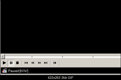

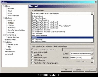

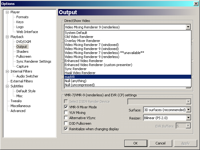

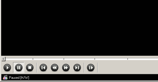

  22. I really don't think there's any magic MPC-HC settings. If you're not using MAdVR I'd go with EVR for Win7 and VMR9 for XP. Other than that it just plays video.
    I don't know if your video card is capable of hardware decoding but if you go into Options, select Internal Decoders and click the Video Decoder button, the LAV Filter preferences will open. Top right are some hardware decoding options. DXVA2 is the native Windows hardware decoding method, or there's NVidia Cuvid. I have to use the latter as XP doesn't support DXVA2 (only the original DXVA). The configuration should show you which types are available. If you change it, select okay and you might need to shut down MPC-HC and open it again for the change to take effect. My video card can decode mpeg2 or h264 video (not mpeg4 such as Xvid). When hardware decoding is used (rather than the CPU doing the decoding) it's indicated below the navigation bar.
    I've attached a zip file for you. If you unzip it and put the bitmap file it contains in the same folder as MPC-HC, it'll use it for the navigation buttons instead of the defaults (you'll need to restart the player if it's running). It makes the buttons a bit bigger and a bit less fugly. Like so:

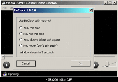

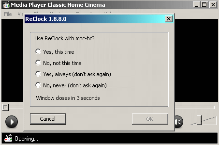

  23. The ReClock message looks like this. It should pop up the first time you open a video file containing audio if ReClock is installed and working. If it doesn't.... well to be honest I've never had to worry about that. It's always worked for me.
    If it's not working I wouldn't stress too much. ReClock isn't really a necessity.

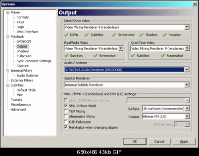

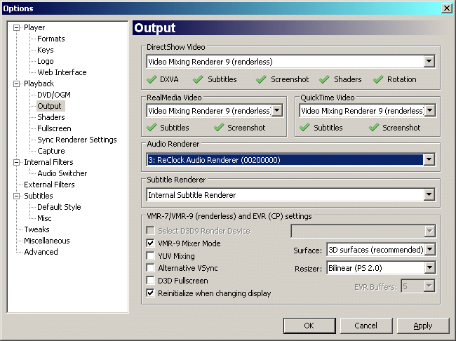

    Although thinking about it.... I think a new audio renderer was added to MPC-HC recently. I don't know anything about it but maybe it doesn't play with ReClock. I'm only guessing as it doesn't work with XP and doesn't even show up in the list of audio renderers, but instead of "system default" you could try selecting Reclock as the audio renderer in MPC-HC's options to see if that works. I've never had to do it myself and I'm just guessing, but you can always change the setting back to the default if it doesn't work or bad things happen. Restart the player after you change it.

    [Attachment 37904 - Click to enlarge]
    [Attachment 37905 - Click to enlarge]
    I will leave off on the big button thing for the moment with thanks for the link.
    I reposted this with images to ask where does MadVR go in MPC-HC?

    Just now I did load an AVI but in VLC and Reclock was not found. I was unclear
    until seeing the image above that you have to associate Reclock with a player. It makes sense,
    I just wasn't thinking it worked that way-- perhaps as an always on accessory from startup.

  28. I don't use ReClock the way I suggested in the above screenshot because I don't have to. I suggested trying to select it as an audio renderer to see if it'd work that way given for you it's not running automatically. I previously mentioned ReClock doesn't work with VLC. It's a DirectShow filter and VLC is not a DirectShow player.
    Selecting MadVR:
Name:	mpchc madvr.gif
