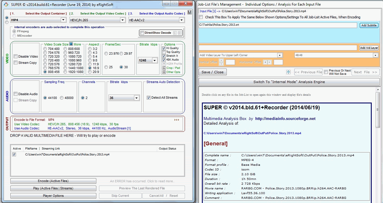

    Sep 2006
    Belgium
    Hello,
    Maybe this image will be useful
    http://www.erightsoft.com/snaps/images/AddSubtitles.gif

    Originally Posted by morenz View Post
    Hello,
    Thanks! It does look pretty easy to use. I'll keep you suggestion in mind
