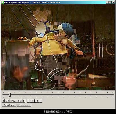

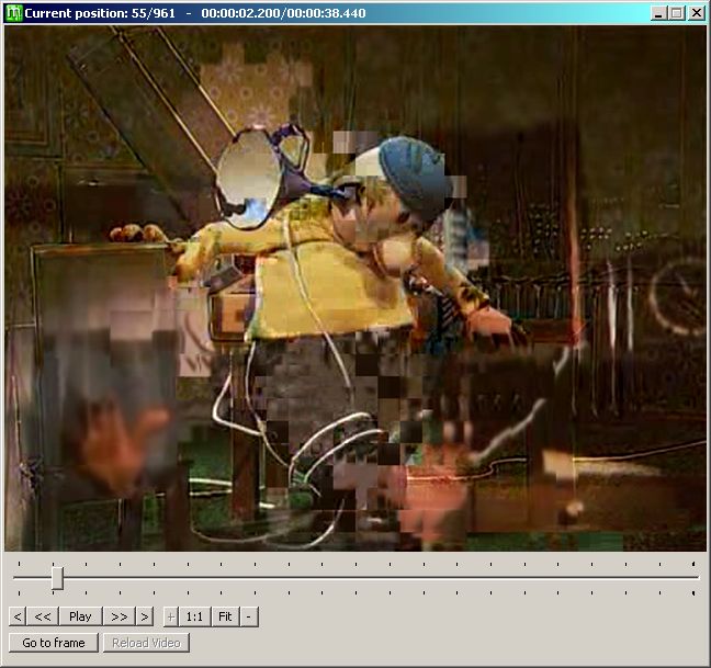

  16. I don't get a grey screen when playing your sample (MPC-HC) but there is an issue decoding the first part properly. Oddly enough it only happens the first time I play the sample and after that it plays fine unless I close the player and start again, but it appears to relate to the smart rendering. I don't know how to fix it though.
    The same thing happens when opening the sample using MeGUI (no matter how I open it), except the problem still remains after playing the video the once.
    Same with VLC for me. Obviously parts of the frame aren't being decoded properly, but there's no grey screen or index warning.
    Sorry.... I'm not much help.

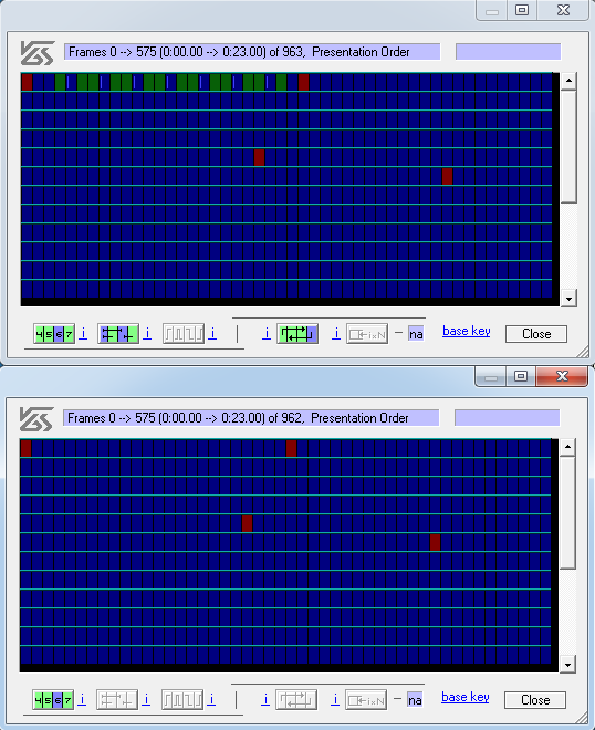

  19. The first GOP has I, B and P frames. The rest of the video only has I and P frames. Try cutting and smart rendering again with b-frames disabled in Xvid. Ie, disable B-VOP in the Xvid configuration.

  22. Originally Posted by El Heggunte View Post
    In the "profile@level" item, click the button "more", then untick "B-VOPs".
    Grey screen on scrolling still appears
  23. Originally Posted by Freodon View Post
    Worked for me when I smart reencoded your sample, cutting the first frame. Use GSpot to check the GOP structure -- the little VGS button. Original top, smart reencoded bottom with no B frames:
    Red boxes are I frames, blue boxes are P frames, green boxes are B frames.
    By the way, DivFix was able to fix the bad AVI.
