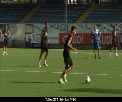

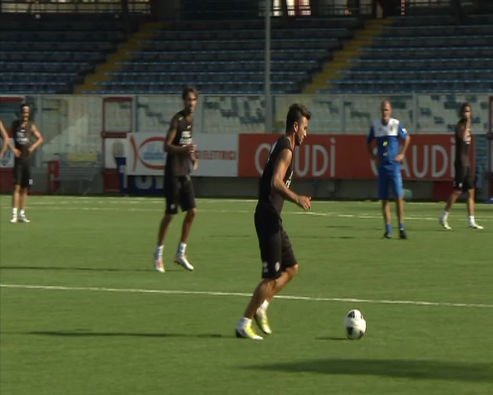

  4. If you want a demonstration, test this in avisynth
    FFVideoSource("C0075Morgan3.mp4")
    ConvertToRGB24(interlaced=false)
    AssumeTFF()
    Bob()
    ConvertToRGB24(interlaced=true)
    AssumeTFF()
    Bob()
    The bob() is just for demonstration purposes to deinterlace to show full frame (instead of field)
    ConvertToRGB24(interlaced=true) means upsample the chroma using interlaced algorithm. (and false means use progressive algorithm). The YV12 4:2:0 material is converted to RGB for display (your monitor , TV, anything you SEE is usually working in RGB)
    This is one of the reasons why all broadcasters use 4:2:2 for mezzanine , intermediate files, submissions
    Trust me, I'm 100% sure about this, just like the other thread

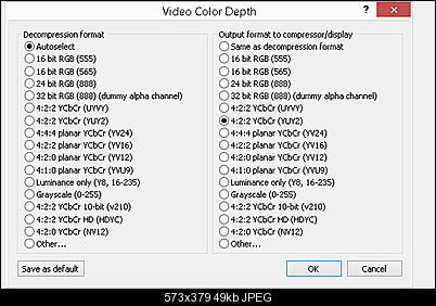

  7. So the take home message is be careful when using interlaced 4:2:0 material. If your NLE, vdub don't upsample to RGB correctly , you will have those artifacts when working in RGB
    Either convert to 4:2:2 intermediate first, or set the program so it inteprets the chroma correctly
    In vdub, another workaround is video=>color depth => 4:2:2 YCbCr . You will notice the artifacts vanish mysteriously in the preview. The reason is the vdub author purposely chose to adhere to the "interlaced 4:2:0" doesn't exist set of interpretation rules, so it uses progressive chroma upsampling . (This is probably same as your NLE) . The problem with 4:2:0 interlaced is chroma information is only present every 2nd line

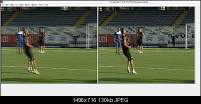

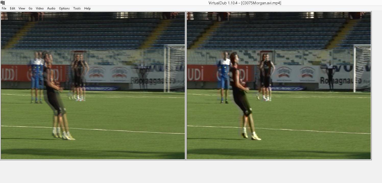

  8. in fact if I open C0075Morgan.avi.mp4 into vdub and add filter deinterlace I see this:
    so I wonder: what is the method to see if are presents ghost?
  9. Originally Posted by marcorocchini View Post
    If you're going to use vdub to check, force YUY2 color depth as explained above in post 37
    My method of choice is to use avisynth and look at individual fields with separatefields(). I like individual fields, because it can reveal other field issues that might not be easily seen with deinterlacing or on full frames

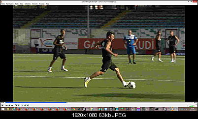

  10. in vlc I have set deint. mode=yadif and view deinterlace
    seems don't see ghost in you mp4Click image for larger version

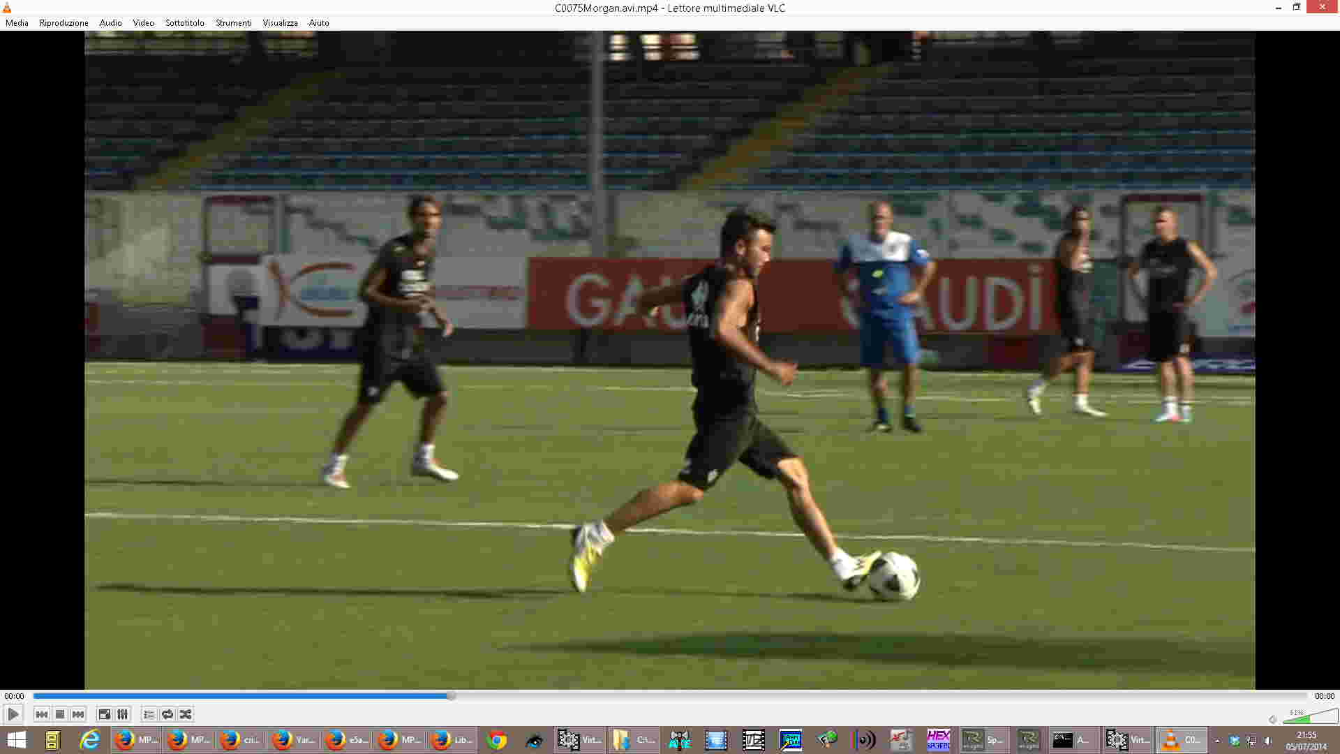

  11. Originally Posted by marcorocchini View Post
    seems don't see ghost in you mp4[ATTACH]<snip>[/ATTACH]
    and that is expected result , because the deinterlace is applied before conversion to RGB in the sequence of events
    once video is deinterlaced, it is now progressive 4:2:0 , so progressive conversion to RGB looks ok

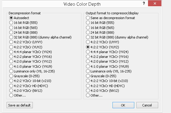

  12. I have jet set virtualdub to work in yuy2
    but seems it work alwais with ghost when I open 4:1:1 files
    Can I set virtualdub to avoid this?

  15. Maybe something has changed in newer vdub versions.. you used to be able to use that force yuy2 workaround with color depth. Looks like it's not working
    I'll have a closer look later, but stay away from extinct dinosaurs, at least temporarily
