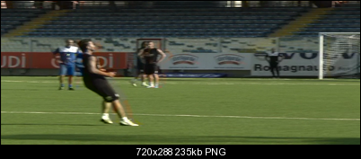

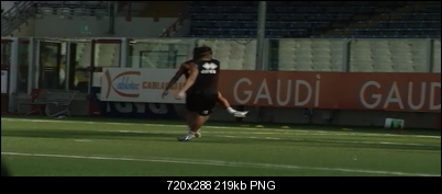

    I already explained in the other thread; MBAFF is a type of interlaced encoding. Look at the file in a non deinterlacing software media player and you will see combing from distinct fields. Maybe that your device doesn't support it automatically, or you have to manually activate deinterlacer. Eitherway - x264 doesn't support PAFF, only MBAFF . Most devices don't have problems with MBAFF (e.g. it's even supported on blu-ray) . But field wise, the file is fine. You check it in VLC and activate the deinterlacer

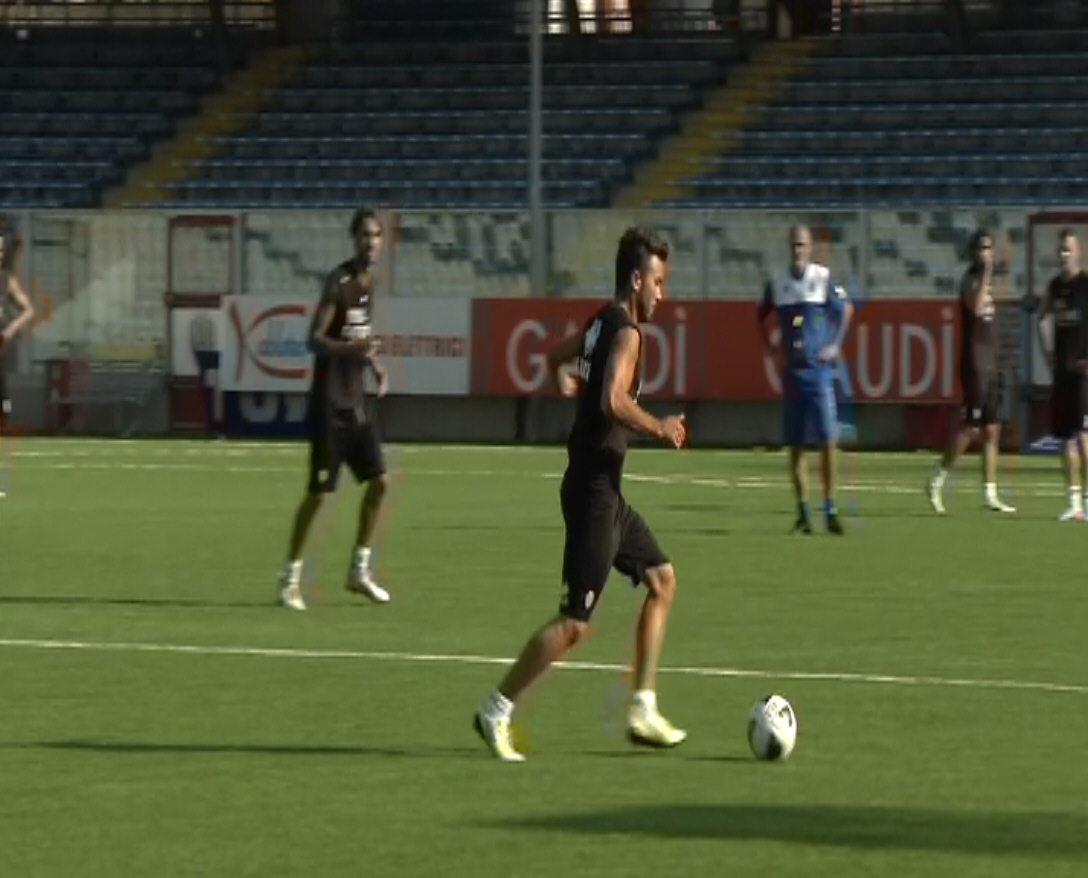

    This is another topic but tmpgenc file hasn't converted the file correctly (non interlaced aware chroma scaling). Look at the chroma problem "ghosting" in individual field (look at the billboard sign, discolored arm)
    TMPGEnc
Name:	576 tmpgenc chroma issue.png
    ffmpeg with interl scaling, levels force
Name:	576 ffmpeg il.png
    If you don't use the interl=1 , there will be chroma ghosting in the fields as well
    mjpeg is not a great intermediate for ffmpeg, because it's decoded at full range. Some programs clamp to std range , other go full. It 's a big headache . So when you go full range yuvj422p to yuv420p, you will get a PC=>TV levels conversion and low contrast. That was discussed in one of your other threads. You need to pay specially attention to -vf scale with the range flags when using mjpeg, and interlaced scaling with interl=1 . But becareful how you export mjpeg, because if it contains actual full range values, bright swill be blown, darks will be clipped . For example , there are significats of highlights > Y=235 . You avoid all this by using mjpeg
    -vf scale=w=720:h=576:interl=1:in_range=tv:out_range=tv
    The tmpgenc file doesn't use b-frames either (-bf 0 in ffmpeg)

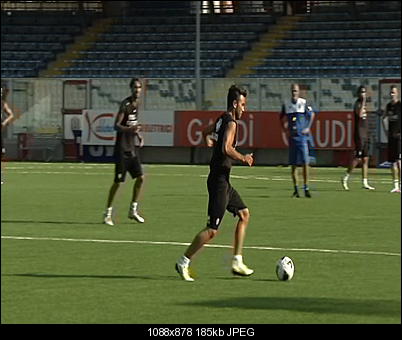

  14. please poison I have use:
    ffmpeg.exe -y -i c0075.mxf -vf crop=720:576:0:32,scale=interl=1:in_range=tv:out_range=tv -pix_fmt yuv420p -c:v libx264 -profile:v main -level:v 3 -g 33 -bf 1 -crf 18 -flags +ilme+ildct -aspect 16:9 -an out.mp4
    in this moment I'm upload on my dropbox the C0075.mxf however I think there is chroma ghost, but I think have use the -interl have you idea to resolve? thanks

    You can see the effect interl=0 vs. interl=1, same commandline as previous post except for interl=0 vs. 1
    These are separate fields:
    interl=1
Name:	35 interl=1.png
    interl=0
Name:	35 interl=0.png
  25. mmm this time I have used ffmpeg 3 july 2014 (the latest from zeranoe) however I see the ghosts in image
    I have use:
    ffmpeg -i v:\C0075Morgan.avi -vf scale=w=-1:h=-1:interl=1:in_range=tv:out_range=tv -pix_fmt yuv420p -c:v libx264 -profile:v main -level:v 3 -g 33 -bf 1 -crf 18 -flags +ilme+ildct -x264opts tff=1:ref=1:colorprim=bt470bg:transfer=bt470bg:colormatrix=bt470bg:vbv-maxrate=10000:vbv-bufsize=10000 -an -aspect 16:9 z:\C0075Morgan3.mp4
  26. "C0075Morgan3.mp4" is fine
    It's a playback problem (likely your software is upsampling to RGB using progressive algorithm)
    How are you viewing it ? What software, how is it configured

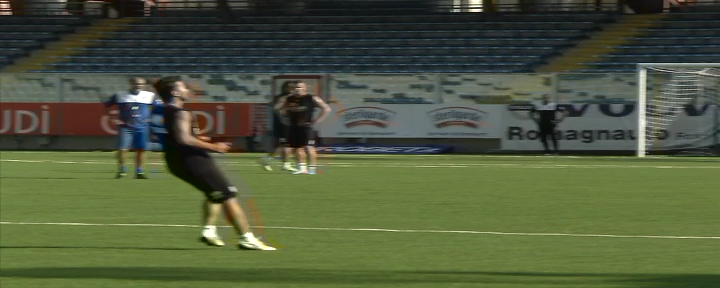

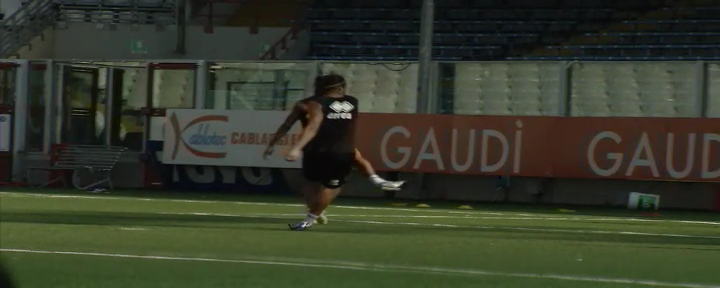

  27. I have download your C0075Morgan.avi.mp4 : is ghost-free it? because seems to me to see jet ghost
  28. Both are "chroma ghost" free. Again, it's a playback problem. You can prove this by viewing individual fields, or viewing it properly
    However, the earlier tmpg file has real ghosts (they are encoded into the fields) , "C0075Morgan.avi_interl=0.mp4" has real ghosts as well

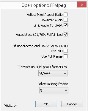

  29. I open the mp4 with virtualdub with the ffmpeg plugin
    and save it as uncompressed avi (yuy2)
    and then I place in timeline the uncompressed avi in S****R**** 5.51 connected to a Matrox Digisuite system and seen image on a crt monitor ....
    but the strange is this: the commandline that generate a 422 mp4 does not do the problem. Ghost are visibile only in 411 mp4 files
  30. Originally Posted by marcorocchini View Post
    [ATTACH]<snip>[/ATTACH]
    The reason is 4:2:0 vs 4:2:2 handling of interlaced material . Your *NLE* upsamples 4:2:0 YV12 like vdub. Interlaced 4:2:0 material doesn't exist according to some definitions. So it upsamples interlaced 4:2:0 using progressive algorithm
