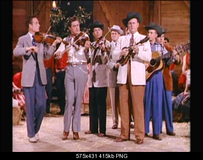

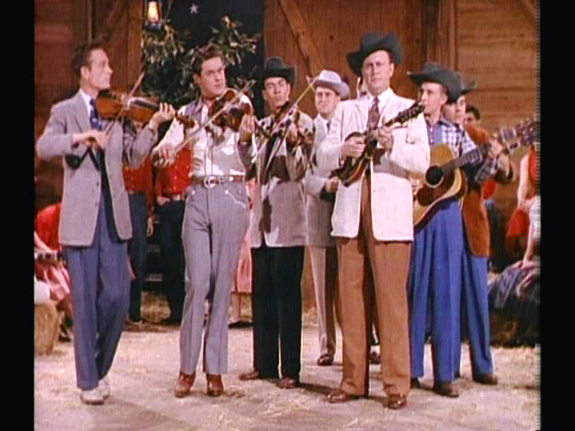

    With succes I changed the aspect ratio of my mp4's, without re-encoding (!) using MP4Tools.
    MovieConverter-Studio is succesfull at changing from 4:3 to 16:9 and vice versa, without re-encoding (!)
    But how to handle a clip like this?
    http://files.videohelp.com/u/203833/Bill%20Monroe1.mpeg
    The original clip is 4:3, but on the DVD it looks like a narrowed 4:3.
    Does anyone know a OSX tool I can use to fix this, without having to re-encode?

  2. It's a messed up clip. Looks like someone took a 640x480 video and plunked it 1:1 into a 720x480 frame (and probably cropped a bit from the top and bottom as well.) Neither 16:9 nor 4:3 (nor 14:9) will give you a correct image.
    Unless your tool allows you to set the aspect ratio to 3:2, you must either crop off the side bars and reencode to 4:3, or add sidebars and reencode to 16:9.
  3. Is this really 4:3 AR? The actual video looks like there's a mask over it making the image appear square. I wouldn't say the people look tall and thin, it looks more like the normal kind of image from that era.
  4. Originally Posted by nic2k4 View Post
    The clothing suggests this clip is from no later than the 1950's, this was shot on film and improperly digitized somewhere along the line.

    This is a mid 1950's clip, produced for tv, thus originally 4:3.

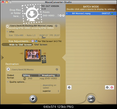

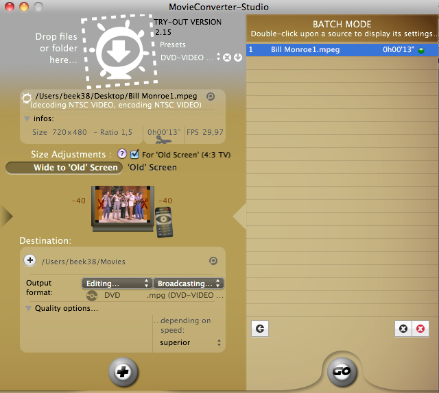

    Herve, Thank you for the info. I didn't know your soft could do this. However, I tried it out, but it didn't work. Please take a look at the screen shot, and tell me what I did wrong.

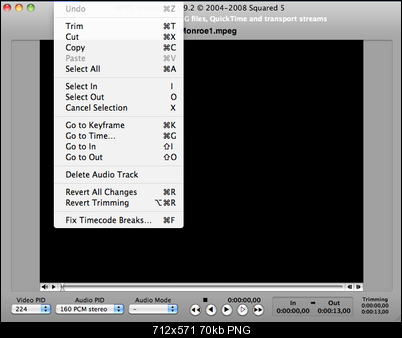

Name:	Screen shot 2014-07-02 at 22.37.05.png
    Again without knowing what tools you are using (why not tell us?)
    smrpix, The tool I'm using to do the two-step is MPEG Streamclip.
    But I still don't understand why you're forced to do this two-step.
    smrpix, If I can use Herve's soft to do the trick, I will certainly go for it. And I'll certainly give Adobe Media Encoder a try too.

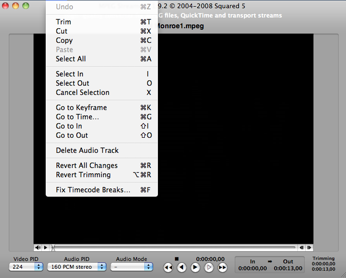

  15. It looks like the PC version can. Doesn't the Mac version have crop filter, resize filter? (it's called swsResize in the version here)
    Aug 2011
    Holland, Europe

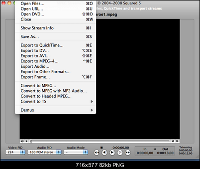

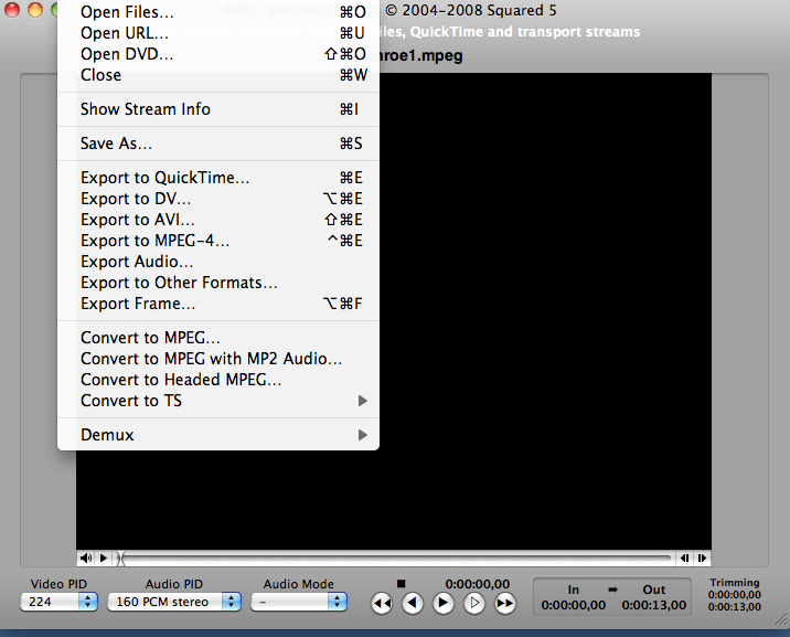

    poisondeathray, This is how the Mac version of MPEGStreamclip looks:
Name:	Screen shot 2014-07-03 at 12.52.08.png
ID:	26033Click image for larger version
Name:	Screen shot 2014-07-03 at 12.52.21.png

    I hope you can help me out with MovieConverter Studio? As far as I can see I put all the settings like you said. In the preview window everything seems okay, but the resulting MPEG2 I get is the same as the original 8:9 video.
  18. Originally Posted by HitTheRoad View Post
    Wrong? Nothing, you already selected a "way to handle aspect of your file". Now just click onto the button "remote control with an eye inside, near the thumbnail" (that's all )
    PS: when you click onto an aspect button (eg: wide screen -> square screen) you have an alert with choices (only with complex…or buggy files ). Choose one and click to preview its result, choose another and click to preview the result, …
    bye

  19. Originally Posted by HitTheRoad View Post
    Herve,
    (I answered before reading this post, I will take a look…)
    bye
    Edit:
    I checked/tested, no concern
    …maybe you forget to validate your custom setting (the selection of the aspect)?
    Do not forget to click onto the "+" button to validate your new setting
    (if you don't, the "Go" button only keep your initial settings before any cutomization )
    bye

  20. Your two-step makes sense with mpegstreamclip since it will only do MPEG as a direct copy, and when you use crop you also do not have access to QuickTime animation (at least on the PC version.).
    Avidemux has the proper functions, but I've never had great luck with it, especially with MPEG streams. YMMV.
    Hopefully, Herve's tool can help.
    Herve, it worked! Thanks to your tool. To my knowledge the only OSX soft to do the trick. Vive la France!
    There's only one question left for me. MovieConverter-Studio provides a one-step option. But... Will this guarantee a better quality than the two-step MPEG Streamclip workflow I described above (conversion to DVCPro50 + cropping at the same time > new MPEG2 file)?
