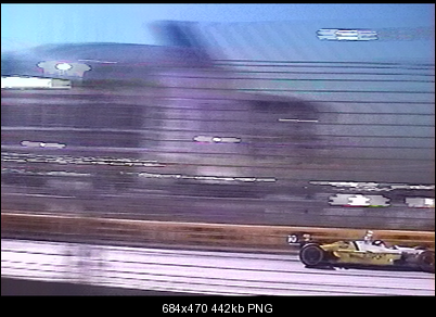

  1. I cam capturing 8MM from a sony handycam using a Plextor PX-AV100U (analog). No compression YUY2. Its raw untouched video. The raw video has the "lines" (see image)
    I know i'm not supposed to de-interlace when converting to DVD, but if I DONT, the video WILL show the lines ON THE TV (using a DVD)(see image)
    If I DO de-interlace, the DVD looks fine. Am I missing something?

    because you're playing the interlaced dvd on a computer monitor that is designed to only show progressive scan type video, any time you play an interlaced video on a progressive screen you will get those lines.
    if you were to play the dvd on a tv that outputs interlace content, then you wouldn't see any lines.

    If the dimensions for the image you posted (674x470) match those from the video, your video is the wrong resolution for DVD. Video must be de-interlaced before re-sizing.

    The clip you posted shows interlaced video that says progressive in the header. It also plays bottom field first when it is actually top field first. The x.264 clip you posted is not DVD legal anyway, it needs to be mpeg2. Where did the cropping at the top and bottom come from?
  12. The AVI still has the luma channels of the two fields relatively intact. The progressive x264 encoding has blended the two chroma channels together -- assuming they weren't blended together before encoding. Indications are that you should be able to make an interlaced DVD from the original cap. I suspect ConvertXtoDVD didn't identify your video as interlaced. See if you can override that and force it to treat the video as interlaced, top field first.

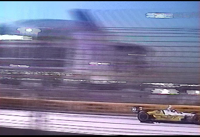

  14. Also:
    Check out this sample in VirtualDub. Video AND Audio are set to direct stream copy (no filters set, and nothing else that I can think of)
    Why is the new video smoother? (but still crappy)

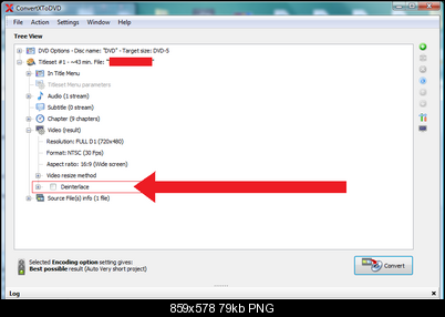

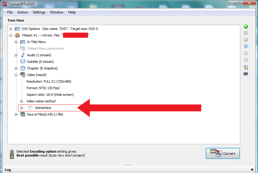

    ConvertXtoDVD has one of the best deinterlacers I know of.
    To most people it's a hidden setting they have never even heard about.
    Try checking the box before conversion and see if that works for you.
  17. Originally Posted by transporterfan View Post
    [Attachment 25958 - Click to enlarge]
    Thats exactly how i've been doing it. When I do this, the DVD looks fine. But am I sacrificing any quality?
