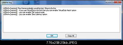

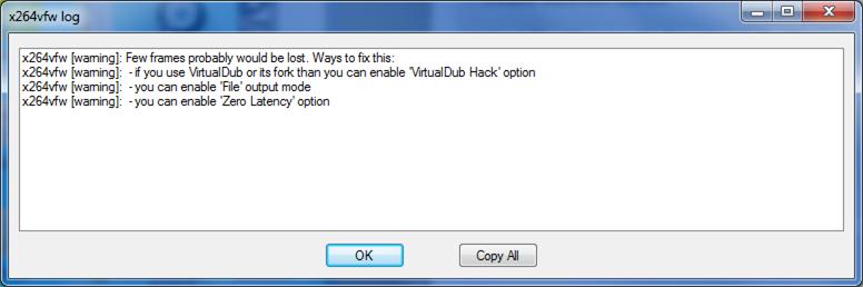

  4. There is nothing listed when you click on 'Virtualdub'
    However have no managed to get codec installed ...
    Trying it out throws up a string of errors:
Name:	X264 error.jpg
    Will work though them .... if there are any recommended settings I need to configure on this codec please feel free to let me know.
  5. OK .. found that only the VD hack enabled would work ... and cleared the issue.
    Not a perfect way to evaluate .. but played about with quality setting until file size matched original ... and found that setting of 21 achieved that.
    Certainly no visible compression artefacts as for the ffdshow codec.
    Would be keen to know if anybody has recommendation on any of the other settings (multi pass for example)
  6. Originally Posted by Tafflad View Post
    Open your browser full screen. There are links at the far right.
    [Attachment 25947 - Click to enlarge]
    You're using x264vfw and Save as AVI? I though you were saving directly as MP4 files using VirtualDub's ability to use external encoders and muxers. That's what my earlier link was for. Beware, some players won't play h.264 in AVI.
