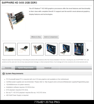

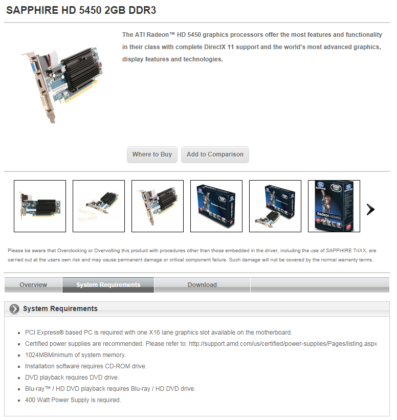

    If it's that particular model, says the minimum is 400 watt
    In fact most of the r7 250 models i looked at need either a 400 or 500+ w psu.

    So you were told what was clearly stated in the above linked pic. Your PS is out of spec. Just because it's been working for a while doesn't mean it will continue to work.
    if you're just waiting for some fool to agree with you, good luck.
