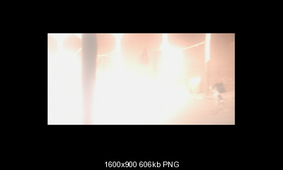

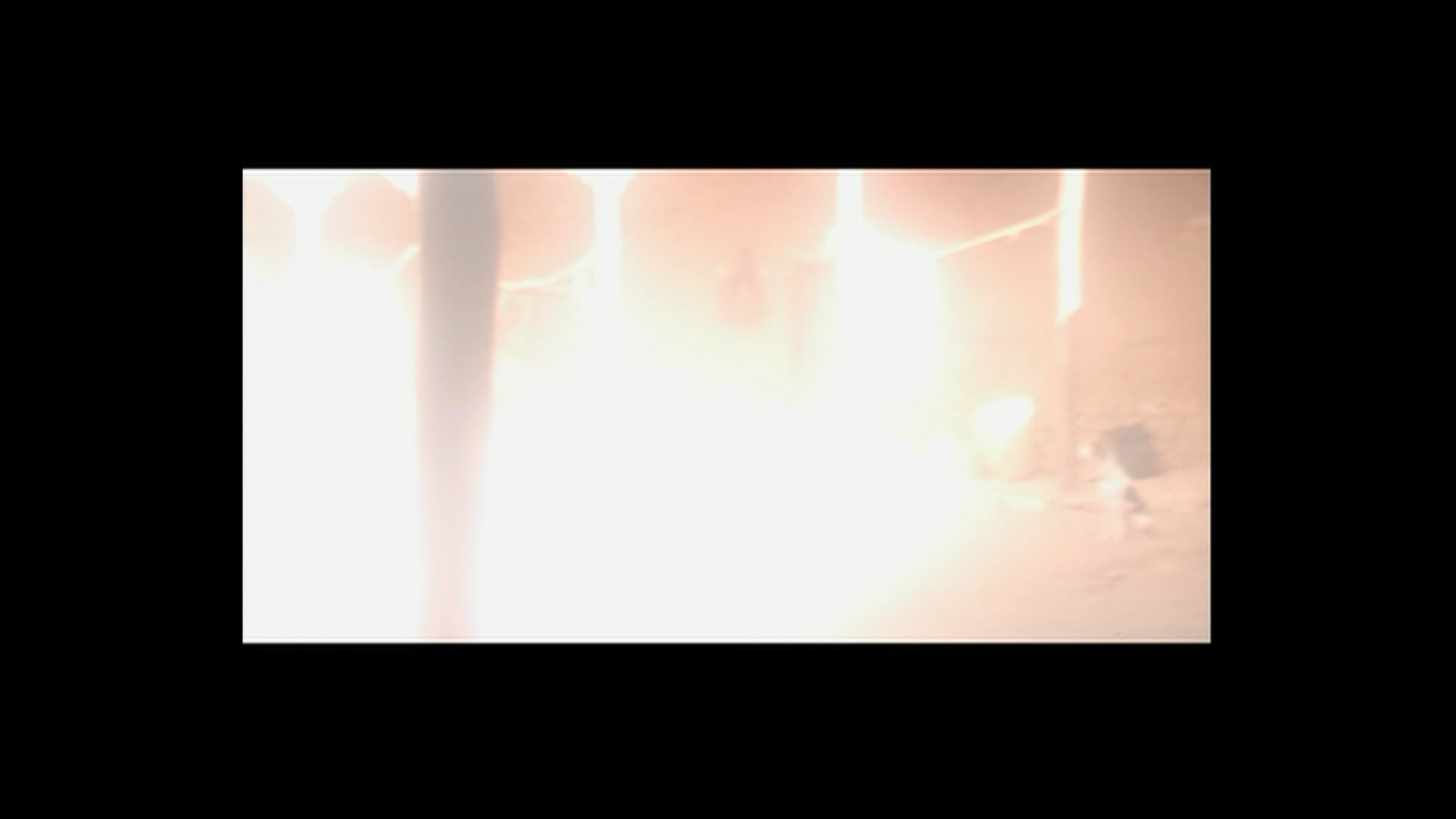

  1. Hello and thanks in advance for any help. I've searched about for an answer to my question but couldn't find anything useful, probably because I'm using the wrong terms. I've a stack of DVD's that I'm slowly-but-surely ripping with MakeMKV then cleaning up and shriveling with MeGUI-AviSynth-SMDegrain so as to make them more portable. Things are progressing reasonably well (if slowly) but I occasionally encounter a DVD where the video playback appears as a smaller rectangle in the center of the screen; that is, it doesn't have the usual two black bars (top-bottom or left-right, depending on aspect ratio) but in effect four black bars. My question: is it possible to "stretch" the video, either during the reencoding or remuxing stage, or some other way, so that the video maintains its proper aspect ratio and two of the sides reach the edge of the screen? I've played around a bit with the format specific options in MKVMerge but unsucessfully. Thanks again for your time.
    Can you post a screenshot? How "big" are the black bars?

  4. Originally Posted by ndjamena View Post
    It's 16:9 or some other widescreen aspect ratio encoded to fit the 4:3 aspect ratio by including black bars on the bottom.
    Something like that, I think. It's a 1997 movie and MediaInfo spits out "720*480 (4:3)" but it doesn't display 4:3 and the image isn't distorted in any way. Here's a screenshot:

    The black bars on the left and right edges are a product of the player, not the video. It looks like the actual video has an aspect ratio of 2:1 or slightly more.

    Your video is a standard 4:3 letterboxed DVD. The side bars are being added during playback.
