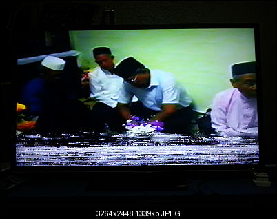

    Hi, as shown in the picture of this thread are static lines, coming from a dirty VHS, isn't it?
    Because at one point of time while playing the VHS, the blue screen with the text "VIDEO HEADS MAY NEED CLEANING PLEASE INSERT HEAD CLEANING CASSETTE" actually appeared. So, i was wondering as to whether this method is the right one to get rid of those static lines?

    I'm not so sure it's the VCR or tape that's dirty. Sometimes a VCR gives out that warning simply because it doesn't like a tape.
    At any rate, you have three options if you do indeed want to clean your VCR:
    1-(OK IMO) You can use a cleaning tape (but many have varied opinions on this, dry and wet cleaners)
    2-(BETTER IMO) You can try cleaning the VCR by playing a brand new blank tape for an hour (depending on the tape length, this could be good for a couple of separate cleanings, but dispose of the tape after done).
    3-(BEST IMO) You can actually open up the VCR and go through a few tutorials on YouTube on how to clean your VCR, which are also very similar to that link you posted. So yes, IMO, I think this is the best method.
    If cleaning doesn't help, and you know AviSynth:
    If you can adjust the tracking where it's not so bad, just a few random white streaks, this is easily corrected by capturing the tape three times and using median methods with AviSynth.
    If your tracking works best on one part of the picture, and another tracking scheme works best for the other parts of the picture, then you can capture it with each tracking scheme, and combine the pictures later with Avisynth and StackVertical and/or StackHorizontal.
    Or, with tracking, if you can get the fuzzies to be in a small part and edge of the picture, just crop them off after capture.

    It's not "static", it looks like a tracking issue. Have you tried to adjust the tracking control ?

    I also agree with davenet, it looks to be more a tracking problem than "static" or a cleaning issue. Most cleaning issues affect the whole picture fairly evenly (slight, little bit more, little bit more, lot more, full blown snow). "Static" usually only occurs with EMI/RFI and you can usually tell when there's a foreign interference going on, such as a vaccuum cleaner running nearby.
    Could be the tape was recorded with a recorder that already had bad tracking, so adjustment might not completely rid the noise. Only solution then is to find a professional with engineering skills that can mod a VCR to match the tracking that you need.

    Agreee with Cornucopia and davexnet; that looks a lot more like a tracking problem than a dirty-heads problem to me. Basically, there's a misalignment between the angle of the heads and the angle of the diagonal "helican-scan" stripes on the tape, so the heads are only "seeing" part of each stripe. Cleaning the heads isn't going to fix that, unfortunately.
    You may be able to reduce or eliminate it by playing with the tracking controls on the VCR -- but a great deal depends on the source recording. If the VCR which originally recorded the tape had bad head alignment to start with, it may be so far out of whack that you can't adjust the tracking on this unit far enough to compensate. (Or worse, if the original recording VCR's tracking wasn't stable and kept wandering in and out of alignment, you might never be able to get a clean capture no matter what adjustments you make.)

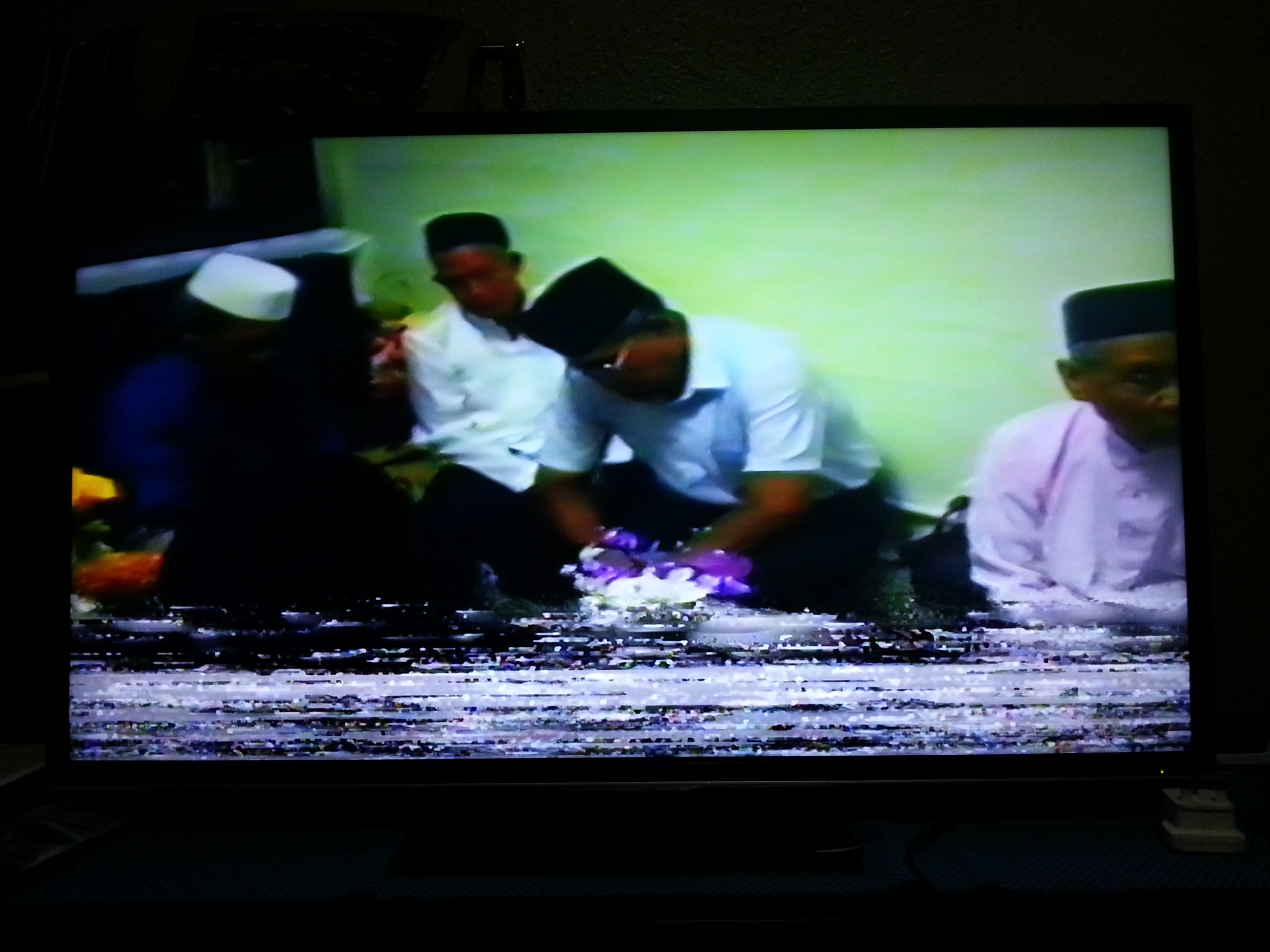

    Hi.. Ok, so sorry to dig thread. Just wanted to follow up and experiment with this static thing.
    Anyway, I'm using a HR-J271MS vcr, I reinserted the video footage and had it played. I did like what some of you mentioned, that is by playing with the tracking controls. I did that, afterwhich this blue screen with the text "USE CLEANING CASSETTE" came out, and then the static somewhat disappeared, and then the blue screen with the text "USE CLEANING CASSETTE" came out again.
    Any idea what I should do now?

    Ok, i've tried option 2, that is by playing another tape in this VCR, there seems to be static, after which the blue screen with the text "USE CLEANING CASSETTE" occurs again. Time to clean the VCR tape maybe?
