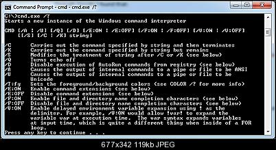

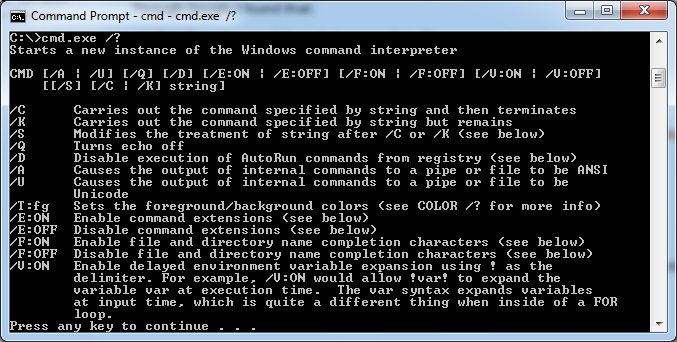

  2. Member yoda313's Avatar
    Jun 2004
    The Animus
    If my dos memory still works don't you just do -? or something like that to pull up all the options in the dos prompt?
    or maybe just ? after the command?
    edit - just tested it it is /? after the exe command. Hope that helps you a little.

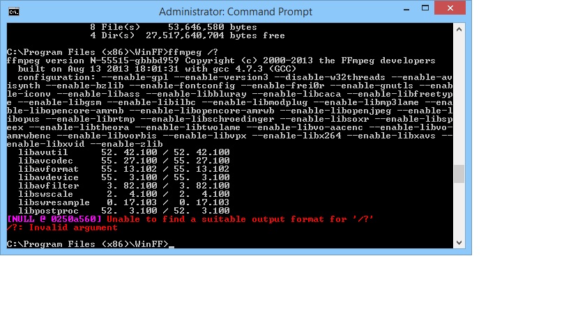

  4. Member yoda313's Avatar
    Jun 2004
    The Animus
    Originally Posted by ndjamena View Post
    ffmpeg -? full
    Like... WOW!
    Glad to help and it is actually /? after the exe. Here is what I got with the version of ffmpeg I have (don't know what version that is):
    edit - sorry selur I don't have that huff or utvideo extensions you mentioned. I'm not sure if this is exactly what you were looking for either. Hope its something at least.

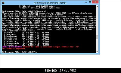

    Sep 2012
    Australia
    Awww, I tried to post the output of ffmpeg -? full but got a server error. But believe me, it's good.
    /? just gives you an error, and it lists the kind of options you SHOULD be giving it instead.
