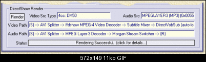

    How to use video path information from GSpot do decode video and audio?

    Use mediainfo,it supports more files and gspot is no longer being updated.
  3. You piece together directshow components in a program like GraphEdit or GraphStudio.

    The "Video path" in the rather outdated GSpot shows about the same result as the "Render media file" feature of GraphEdit/GraphStudio: They report which DirectShow filters a generic media player would be able to use to play the video.
    But high quality video converters do not rely on DirectShow filters, they will usually prefer their own decoders instead.
