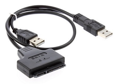

    I have an old internal Hard Drive connected to a USB To SATA 2.5" External HDD SSD Hard Disk Drive Adapter (see picture) i have tried my laptop and PC and still i cannot get either of them to recognise the hard drive. Nothing showing in computer.
    Any advise would be most welcome.

  2. Member hech54's Avatar
    Jul 2001
    Yank in Europe
    Power?

    I have tried another internal Hard Drive and that worked fine. Power, it all runs through the adapter.
  4. Member DB83's Avatar
    Jul 2007
    Well explain how the HDD is connected to the adapter. Is that other internal drive's power coming from the PC's PSU ?

    The two usb ends go into LT or PC and the Adapter connecTS to the HD

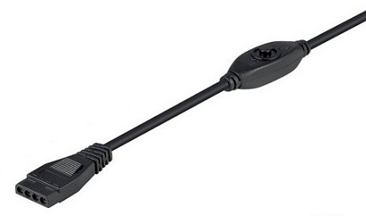

    I'm still going with "Power". This is my adapter:
    hech54, please can you tell me the name of this cable?
    [Attachment 25854 - Click to enlarge]

    The old hdd, is it 3.5"? The adapter shewn only sends 5 v to the drive. A 3.5" drive needs 5 v & 12 v, the usb adapter I use has a 5/12 v power supply.
    That is the power supply to the back of an old(er) IDE drive. I sure hope you didn't jam that SATA connection into the back of an IDE drive.
  11. Member turk690's Avatar
    Jul 2003
    ON, Canada
    Hard drives, even 2.5" SATA ones, consume more current than what a single USB2 connector can deliver so two are available (the power leads in both are in parallel), so when you plug in both USB connectors, hopefully, enough current can be sourced to make hard drive work. But nothing is guaranteed; hard drive may not still be recognized if
    • it requires even more current than that available from two USB connectors (around 1A total)
    • the particular USB controller turns off power to the port if it doesn't sense data connection, making plugging two of them irrelevant if one doesn't have data connection (this particular bridge connector likely does not & can not)
    • the particular USB controller doesn't recognize the SATA-to-USB bridge circuit in the connector
    • the drive may need to be initialized/activated/formatted under windoze disk management
    Note that, to befuddle users of this bridge connector even more, 3.5" HDDs require +12V and +5V; 2.5" HDDs only +5V. I assume the +5V coming off the USB port is just connected straight to the SATA power connection, implying only 2.5" SATA HDDs can be used with this connector, if ever.
