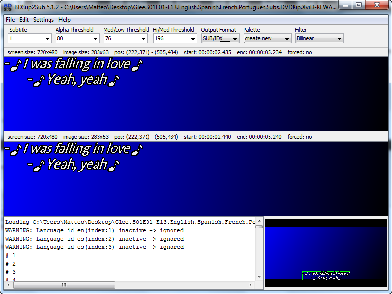

  8. Originally Posted by johns0 View Post
    Load the sub into BDSup2Sub and see if you can export just the english version.
    OK guys, I appreciate your help, really... but I'm not so skilled with this stuff, so you should guide me, otherwise I don't know how proceeding.
    I've loaded the .sub file into the program...
    ... now what I have to do?

    You could try VobSubStrip since its use is dead simple.
    Sep 2012
    Australia
    Forget BDSupToSub, as far as I can tell it doesn't let you select from tracks in an idx file and just ignores all the extras. Use vobsubstrip or MKVMerge/MKVExtract (I had to use the MKVExtract command line to CREATE an idx with multiple subtitles in it to experiment on, and I know it can do the reverse as well).

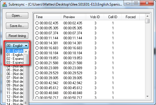

  11. OK, how VobSub works? I load the .sub file and then?
    As you can see, there are two English tracks and two Spanish's. I want to keep just one English and one Spanish.

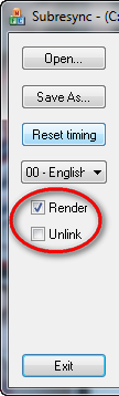

    What the two options, Render and Unlink, mean?

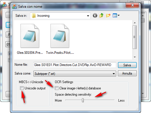

  23. When I come to save the .sub file into .srt...
    ... can you tell me what those three pointed options mean?
  24. You don't just 'save' VobSubs to an SRT file. An OCR has to be done. Either manually, or automatically with varying degrees of accuracy. SubRip is usually better than VobSub Resynch for a manual method. But there are automatic solutions as well. Someone else will have to advise about the arrows as English is my native language. I don't know if you need Unicode or not. What's your language? You won't need the 'Clear Image' checkbox. Keep the Sensitivity slider where it is unless and until you get letters run together or with spaces where there shouldn't be. Only then adjust it.

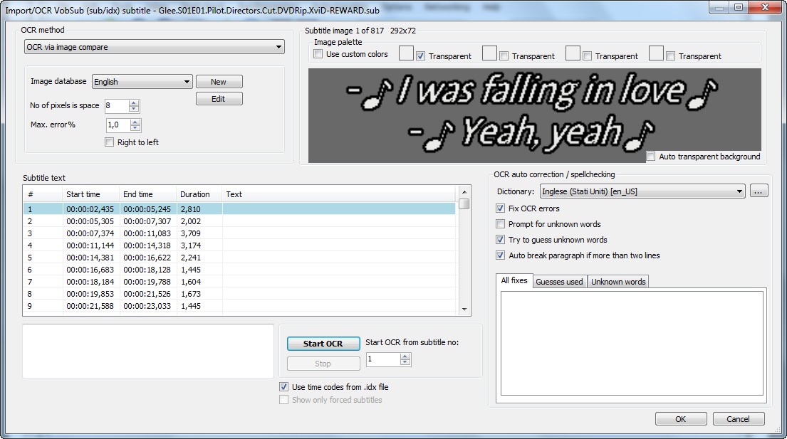

  26. Subtitle Edit and DVDSubEdit are two. Maybe there are more but I don't know of them.
  27. Member
    Sep 2012
    Australia
    I use DVDSubExtractor, I'm not sure if it's better than the others since I've only used Subtitle Edit to convert Vobsub to srt once and that's about it, but you can try it out.
  28. Let's try Subtitle Edit...
    ... is there any option I have to know or to enable/disable?
  29. I don't use them. I use SubRip. Why not just push the 'Start OCR' button and try?

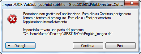

  30. OK, I start OCR, type the underlined character in the text slot below, press OK and I get this error.
