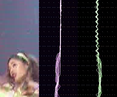

    The TS file shows problems where interlaced YV12 was treated as progressive at some point in the processing. That has caused blending of the chroma channels. The video in post post #92 shows this too. The two videos in post #35, and your latest Lagarith AVI do not have this problem. You need to figure out where in your processing this is happening, or if it's in the source file.
    One common place for this error is in VirtualDub. It treats incoming interlaced YV12 as progressive YV12 when it converts to RGB for filtering, blurring the two chroma channels together. When using AviSynth to feed VirtualDub you need to convert to YUY2 or RGB in AviSynth to prevent this. Use ConvertToYUY2(interlaced=true) or ConvertToRGB(interlaced=true). Or deinterlace the video before giving it to VirtualDub (thereby converting interlaced YV12 to progressive YV12).
    How did you create the TS samples in post 92 (which was compressed by x264) and 98 (which wasn't compressed by x264)?
    I was able to reproduce the green and purple bars from your Lagarith sample with a simple Bob().
    AviSource("Orange Caramel Sample.avi")
    AssumeTFF()
    Bob()
    So as I thought, it was a problem that had to do with de-interlacing? Seeing as Bob() deinterlaces as well?

    No, it's in the video. Deinterlacing just makes it more obvious. The bands are 8 pixels thick so I think it has something to do the quick changing colors and brightness, and the 8x8 macroblocks used in compression. A field or two earlier you can see more random 8x8 blocks.
