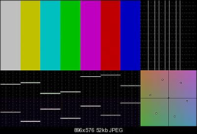

    [...] As a general rule: standard definition video uses rec.601 YUV, high definition uses rec.709 YUV. The correct color model can be specified within the video. But if it's not you have to guess.
    Yeah, I can see the difference, put next to each other. Might be hard if not compared directly though. Thank you for the link!

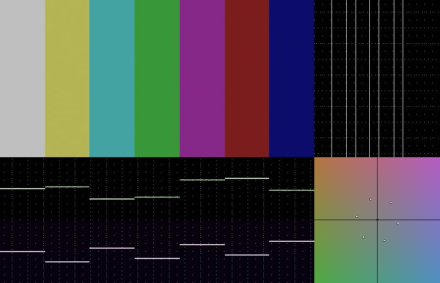

    In truth, I hardly ever use it either. If your video includes a standard SMPTE color bars you can use it as a guide to your color adjustments. That is, you can adjust the hue and saturation (or whatever you need to adjust) to get the color bars right, then hope that that correction holds for the entire video.
    You mean that before or after the program they would broadcast a test screen? I don't know many programs that do that, the ones that I try to edit definitely don't, unfortunately.

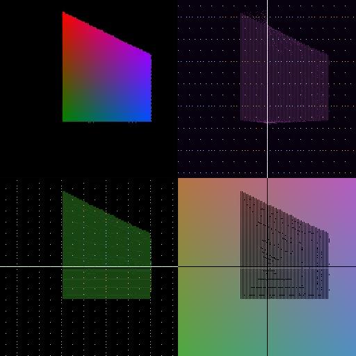

    If you see the vectorscope graph has data out at the very edges (UV<16, YV>240) you know the picture is over saturated -- but you probably already know that just from looking at the picture. I use the U and V waveform graphs a lot more.
    Ah, so that's how you see it, I figured as much, looking at the Orange Caramel vectorscope.
    Yes. You need to ConvertToYUY2(interlaced=[true or false]) before calling VideoScope().
    Okay, then I saw that right, thanks!

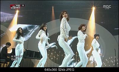

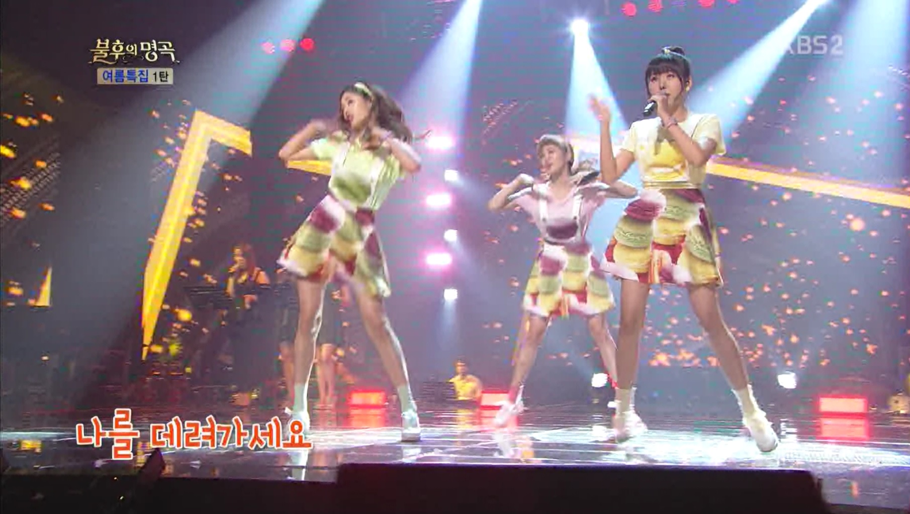

  2. Okay, so it's been kind of quiet. I've been playing around a bit, looked at a few other videos I have and am quite stumped at how broken those are. If you've gone crazy trying to figure out how my first video got past QA for TV broadcasting, you don't want to see the rest, haha.
    That's not what I'm here for, I just wanted to "hand in" my so far final result of the video we discussed here for the most part. Just so you see how it came out, I figured you might be interested. I pretty much took a bit of what everybody suggested and maybe fiddled with a variable or two, it's pretty much the things you've posted here. The colours I did "myself", I played with ColorMill and while I think it looks better than before, it's far from perfect. There's a bit too much blue in some scenes, unfortunately, turning down the blue means too much green and red and it's an endless cycle. It's hard to get it exactly right.
    The only thing I tried on my own was when I noticed that adjusting the colours with ColorMill left some noticeable banding in some spots. I ran GradFun2DBmod() over that, it still left some banding, but it helped out a bit.
    It's a 10 second sample again, I tried to roughly cut out the same 10 second bit I sent as the original sample. It's the finished mp4 (I like mp4 because it's quite light hard drive space-wise), the Lagarith avi was a bit large.
    If you have any thoughts on the video, feel free to tell me, but this is really just because I didn't want to leave abruptly without saying anything
    On that note, a final huge, gigantic THANK YOU to everybody involved! You guys opened a lot of options to me, some of which I'll have to put on hold due to other priorities at the moment but still, you gave me exactly what I needed, a good intro into the whole matter. I'm really grateful for all your efforts!
  3. Color adjustments are very subjective, but it looks to me like you've reduced the highlights too much .
    Have a look with histogram() (it's really a Y' waveform) on the output video, you will see significant amount of unused headroom. When you reduce it that much , you tend to get this "burn" effect where there is no separation in levels, low highlight contrast - ie. the details become reduced to fewer "shades". White doesn't look white anymore, it becomes "grey" (but you've made some adjustments to make a reddish tint to it). Another way of saying this is you're using a limited dynamic range, when you have more available

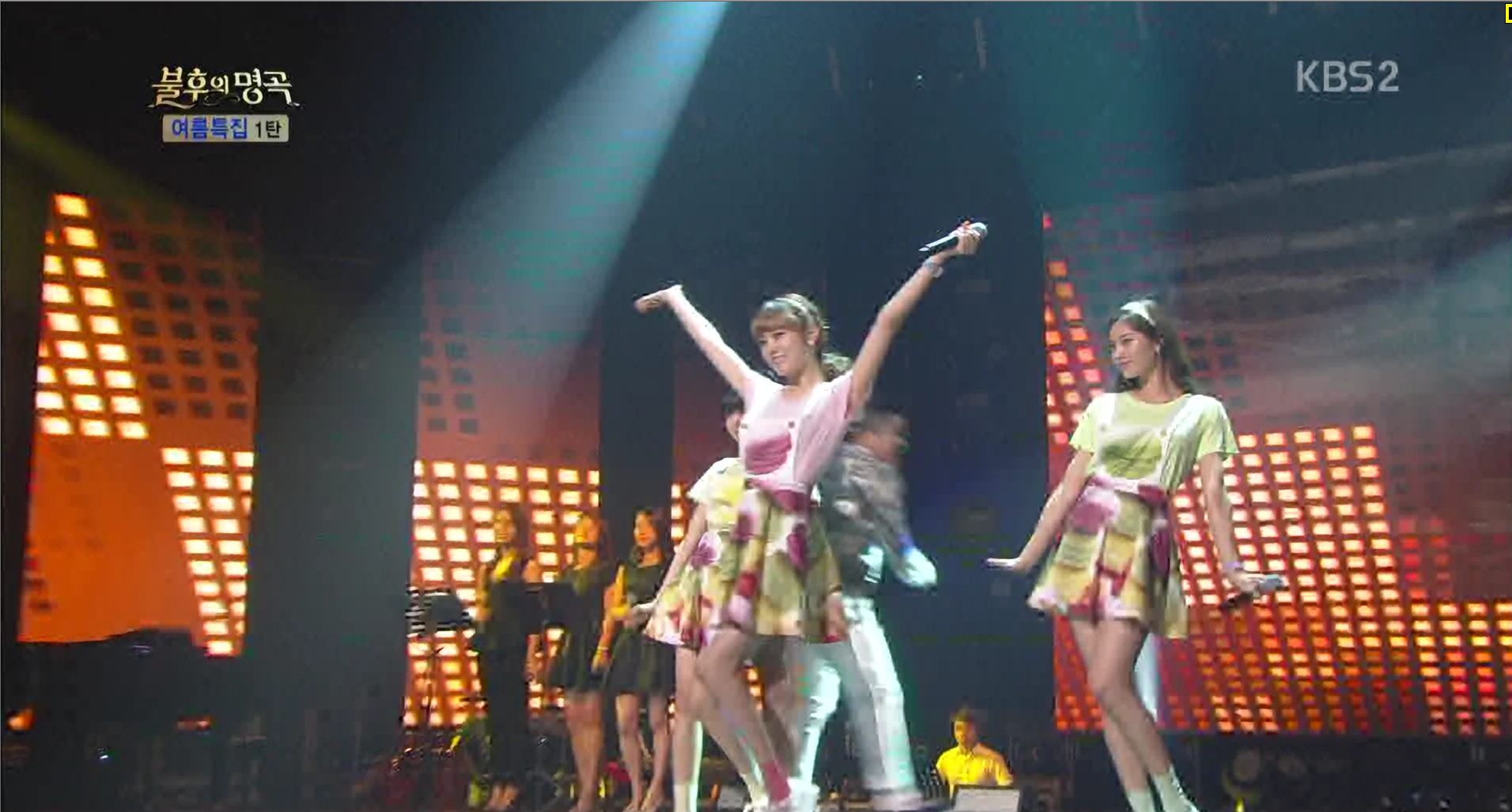

  4. I think you reduced the bright levels but not in a way that restored any of the details above Y=235. That is best done in AviSynth with something like ColorYUV(gain_y=A, off_y=B). Be careful if you use Tweak() -- it crops brights and blacks by default. If you do it in VirtualDub you must use a filter that works in YUV. Otherwise VirtualDub will convert the video to RGB, losing the super brights and super blacks before the filter is applied. The Brightness/Contrast filter in VirtualDub can work in YUV. So use that before any others.
    The video is also over sharpened. The original video already has some over sharpening halos (my guess it was originally 720p and was upscaled to 1080i with sharpening) but your additional sharpening has really accentuated the halos.
    One thing I wanted to mention about color adjustments: These are stage productions. There are colored lights all over the place. It wasn't the intention of the producer to have perfectly natural colors everywhere. This is also true in movies where colors are often intentionally tinged to add a sense of warmness, coolness, night, etc.

    Your two samples are different. As I said earlier, it looks like the boys in the control room were stoned. Or they did a few b.s. things on purpose that some might think are cool, but I wouldn't be paying money to watch it. Again, each of those 4 shots has a different color balance and levels, even with blue overheads and foots shutting on/off and yellow floods doing floor sweeps. The levels are haywire and the green cast is too uniform. Looks like something out of a video player that had the wrong IRE settings.
    Even with videos I had to repair, I seldom had to cut up separate scenes. It's more common with VHS. A tape looks different every time it's played (that's why I make 2 or 3 captures of my old tapes). Mainly I start by setting some dark and bright YUV levels to cover some of the wildest and craziest parts of a video. If the original is a real mess, it usually requires detail work in RGB -- but not always. RGB has filters that let you control very specific areas of an image without affecting other parts. Most of the work I did on that color-graded mkv was with gradation curves, and ColorMill sometimes to tweak it.

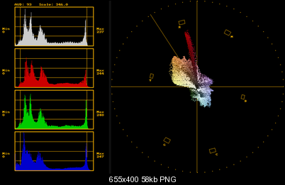

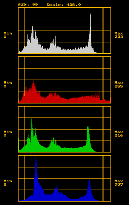

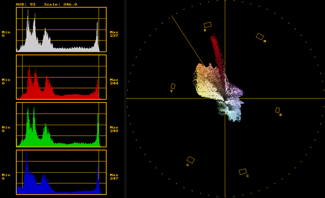

    Here's an RGB histogram and vectorscope of filtered Scene 1. You can see I have brights looking just a little bit hot, though not as hot as the source. Those sharp "peaks" at the right-hand sides of the histogram show clipping in the original:
Name:	Scene 1 - RGB Histogram and Vscope.png

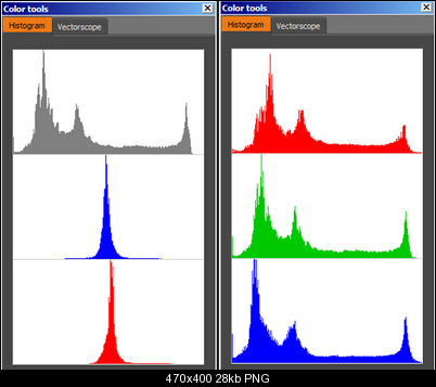

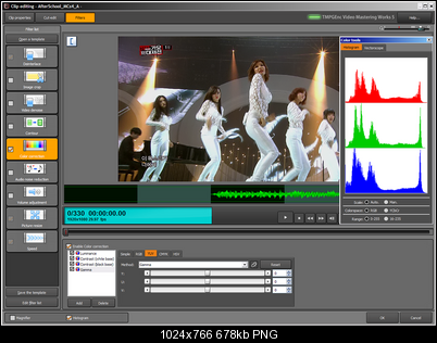

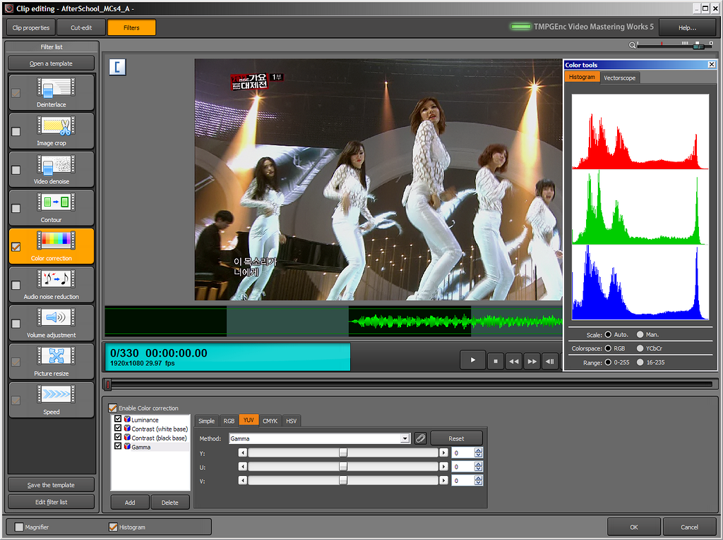

    TMPGenc's TVMW5 encoder gave me these histograms (YUV on the left, RGB at right).
Name:	TVMW5 YUV and RGB.png

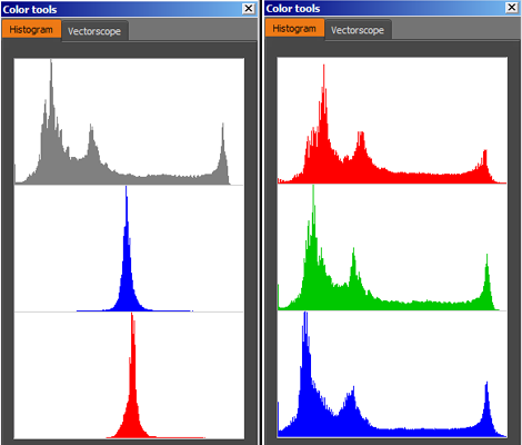

    Working without these tools is a pain. They would have revealed that in the Finished mp4, luma was depressed but red was soaring beyond RGB255 at the bright end. Poisondeathray commented on these effects:
    Name:  Finished mp4 - RGB.png

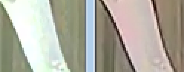

    It's over sharpened?

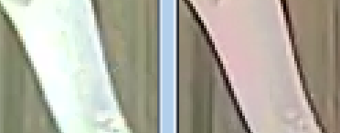

    Yes. Use a magnifier and look at sharp, high contrast edges. You'll see halos. At the transition from dark to light there is an extra dark band in the dark area, an extra bright band in the bright area. A 4x point resize of a small area in the original source on the left, your sharpened version on the right:
    There is a bit of a halo in the original image and your sharpening has strongly increased it. Below I used a quick DeHalo_alpha(rx=2, ry=2) to reduce the halo then sharpened the image a bit to approximately match your sharpness (again, your processed image on the right):

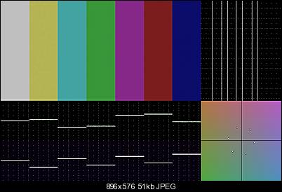

  12. Some notes on hue and saturation and the UV vectorscope:
    Hue is the angle of rotation about the center of the UV vectorscope. A straight line from the center of the UV vectorscope to the periphery is of constant hue, increasing in saturation from the center (grey) to the edge (fully saturated color). The attached AviSynth animations show hue and saturation changes via Tweak().
    This first script uses standard SMPTE color bars to show the effect of hue changes with Tweak(). As you can see, changing the hue rotates the UV coordinates about the center of the UV plot. This is similar to the "tint" control on your TV.
    Colorbars(width=640,height=480, pixel_type="YUY2")
    Trim(0,360) # only 361 frames
    Crop(0,0,-0,320) # just the colorbars
    AddGrainC(0.0, 1.0) # add noise to the chroma channels to make the dots in the UV vectorscope bigger
    Animate(0, 360, "Tweak", 0.0,1.0,0,1.0,false,false,  360.0,1.0,0,1.0,false,false)
    VideoScope("both", true, "Y", "UV", "UV")
    This second script uses SMPTE color bars to show saturation changes with Tweak(). Increasing the saturation increases the distance from the center of the graph to the UV coordinate -- but they move in straight lines from the center to the edges. This is similar to the "color" control on your TV.
    Animate(0, 360, "Tweak", 0.0,0.0,0,1.0,false,false,  0.0,1.0,0,1.0,false,false)
    I used AddGrainC(0.0, 1.0) to make the dots in the vectorscope bigger. You can leave that out but you will see single pixel dots. In both scripts Y never changes. You can see that in the Y waveform display at the top right. At the bottom left you can see the U and V waveforms.

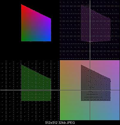

  13. Originally Posted by bschneider View Post
    U and V values need to be within the RGB cube partion of the YUV colorspace, not simply between 16 and 240.
    Okay, so how to check for correct luma values is obvious, how do I check this for U and V? Histogram("color") won't help me here, right?
    That's correct. Histogram("color") is of limited usefulness for this. You can use the HightlightBadRGB() script I linked to earlier.
    Here's a video that uses HighlightBadRGB() to display cross sections of the RGB cube in the YUV colorspace. It starts out with all pixels set to Y=0. At frame 1 Y is increased to 1, at frame 2 it's increased to 2... up to Y=255 at frame 255. In every frame U and V are gradients cover the full range of possible U and V values, 0 to 255, and all ~65000 possible combinations. HighlightBadRGB(0) is used to blacken out all pixels where U and V fall outside the RGB cube. So each frame of the video shows all valid RGB colors available at that Y value. This is based on the rec.601 RGB/YUV standard.
    Sample of frame 80 (Y=80):
    Ah right, I totally forgot. I'm going to save that script. If I do find out that I have bad colours in there, what can I do to "fix" the colours so they appear relatively normal after conversion?
    Thanks a lot for the animations too! I saved them in a file, just for safety, it's really useful to be able to take another look to see how Hue and Saturation work.

    Here's a pic of TMPGenc TVMW5's color filter interface. At the bottom of the pic I've loaded some yuv filters, but made no adjustment here. The video loaded was the one done in VirtualDub. Upper right, the histogram shows RGB results. You can see it in YUV, too. Just a suggestion, but I use this app all the time for quick work in SD and HD. Has pretty good encoders, MPEG2 and x264. Also has a simple but useful timeline mode. Like many folks I've used TMPGenc stuff for years, doesn't cost a fortune. Click on the image in your browser to see it full size.
Name:	TVMW5 sample C.png
    There are other workarounds. Some guys at doom9 use VirtualDub filters in avs scripts and AvsPMod. Personally I think that's a nightmare, but some people just have morbid phobias about virtualDub. Kind of like using a tank to move your furniture around.

    Originally Posted by LMotlow View Post
    Like jagabo said, his script for Invalid RGB and even some other scripts for RGB that run in Avisynth can give useful info. But readjusting and then running those scripts over and over is a pain.
    Look at it this way: budget NLE's from SONY, Cyberlink, and free stuff and whatnot don't have histograms, vectorscopes, curves, fancy color wheels, and all that for working RGB -- or YUV, for that matter. Better tools are in pricey Pro apps like Premiere Pro, Vegas Pro, Photoshop Pro, AfterEffects. Even pro apps can mess things up when not working with lossless input. It's possible to work in YUV and RGB by eyeball alone. But it ain't easy, even with pixel readers. Then there's the learning part -- even with a still camera it's tough to learn about corrections without those 'scopes to tell you what's happening. Also, if you want to work with loosless HD you'll get mighty big files.
    I saw that the Histograms and such were a bit different, but this type of software is quite expensive, gets updated all the time (by that I don't mean free updates, but completely new versions that cost a fortune again) and gets ever fancier with copy protection, internet activation and physical copies are getting a lot less popular. I don't want to pay a hefty price and then get locked out of the program I paid good money for because I changed my hardware. In the case of TMPGEnc Mastering Works, the site tells me two things I don't appreciate, firstly, that it gives me the German version only (which isn't terrible, but in all honesty, I prefer English, translations to German are often flawed and most of the terminology is in English anyway, so I don't see the point. But I could probably get the English version with a little fiddling). The other thing is that it requires "recurring internet activation". In the end, I don't know how reliable and quick the customer support is in case there'll be a problem and I don't want to constantly be at the mercy of the producer even though I already paid for their product. Which isn't to say I don't understand why they do it, I feel for them and their losses due to piracy, I just don't want to be punished for buying it.
    This is not to shoot you down or anything, I hope you can convince me to buy it (although I don't think "doesn't cost a fortune" as you said applies, 100 dollars isn't pocket change for me ) and you're right, it's a name I read all the time, it seems to be really popular with people who know their stuff and that is definitely a plus. I just want to feel reassured before making such a purchase, in general, the program looked nice.
    That's one reason why many folks still use XP. I know a guy using Win98!
    Oh wow, yeah, I can imagine that a lot of this stuff isn't built for Windows 7 anymore. So far I fortunately didn't run into any problems though. There are times where I wish I had XP back, but Win7 is solid for normal use. Especially since I hear that XP was quite bad in its 64-bit form, never tried it myself though. I might make a small Win XP partition at some point, I do run into problems rarely, but not enough to justify making such a partition for yet.
    I definitely like how it looks and hearing that it has some YUV colour correction filters is certainly a relief, but as I said earlier, I'm a bit uneasy with digital-only DRM-heavy purchases... Especially in that price range. If you could say something about your experience with it, that'd be much appreciated. Things like how many computers you installed it on, if there ever were any problems, if you had to contact customer support once, if yes, were they friendly/fast/helpful? I hope I'm not being too paranoid, but I'm not exactly rich. Not poor either, just at the point where I want to think hard about where to spend my money while still having food on the table lol.

    Yep, you do have legitimate concerns. TMPGenc was just a suggestion, and no sense spending $$$ just to get some image controls. I bought v5 for the x264 encoder/HD decoder and interface. I don't know about the German you mention. Pegasus/TMPGEnc is a Japanese outfit with headquarters in Tokyo and a few big cities around the globe. I guess their installers can do German, but I always specified English. Internet validation at first install is one time for about 10 seconds. They seem to check up at random when they run, but I've run them plenty of times with the 'net turned off. Also transferred them to other machines. Updates are free, not needed unless what you have causes problems. I still use older versions from 2004 and later. I hear no complaints about their customer service, but I never needed it. Other software also uses that validation business, but Adobe gets worse with selling their top stuff by subscription. You don't own it, you just rent it. No, thanks! None of those apps can replace a lot of the repair and restore ability of Avisynth and VirtualDub -- which are definitely cost-effective, I'd say.
    Anyway, there's still work to do in YUV. Stuff I edit from cable TV doesn't need all that work. It's just quick-cut, re-author, and done. It's those internet downloads and tapes and home movies that drive you up the wall.
    BTW, 64-bit is OK but there are very few 64-bit filters for Avisynth or VirtualDub. Doesn't seem to be a big rush to get there.

  24. Originally Posted by bschneider View Post
    Okay, I understood how masks work, your links with the illustrations were very helpful! I wonder how you would create such a mask in avisynth though, it seems complicated.
    Here's an example of how you would use a mask to apply color changes to a video based on the brightness of each pixel:
    bmask=last.ColorYUV(cont_y=100, off_y=-15, cont_u=-256, cont_v=-256)
    Overlay(last, ColorYUV(off_v=6), mask=bmask)
    bmask is a a greyscale version of the video with a little contrast and brightness adjustment. If you add Return(bmask) between those two lines you can view that greyscale image (I did that to get bmask the way I wanted it). Overlay() here uses bmask to control which pixels get the ColorYUV() adjustment. Black parts of the image are unchanged, bright parts of the picture get the ColorYUV() adjustment, greys in between get in between adjustments depending on their brightness:
    Before:
    After:
    You can see that the piano player hardly changes colors. But the bright white outfits lose most of their cyan tint and the women's faces look a little more natural. Getting the brightness mask just right is the tricky part.
  25. Originally Posted by jagabo View Post
    Okay, so the first line describes the mask itself? As in, it tells the mask which pixels to take into account? I noticed that if I lower off_y for example, everything gets a lot darker when returning bmask (obviously), as you suggested, but what this means exactly I'm not so sure about. And Overlay takes all the conditions set by bmask and raises off_v for pixels that aren't completely dark, right?
    Oh yes, I can see a very clear difference! It looks way better! Masks still seem kind of complicated to me. Maybe I should be more specific. What exactly do the variables set in the first line? I know what they do (contrast, offset), but what does it mean? Do you set the mask so that the parts you do not want to edit appear black when you Return(bmask)? As in, if I were to set off_y really low, almost everything would be black, meaning the parts of the video affected by the mask would be much smaller?
