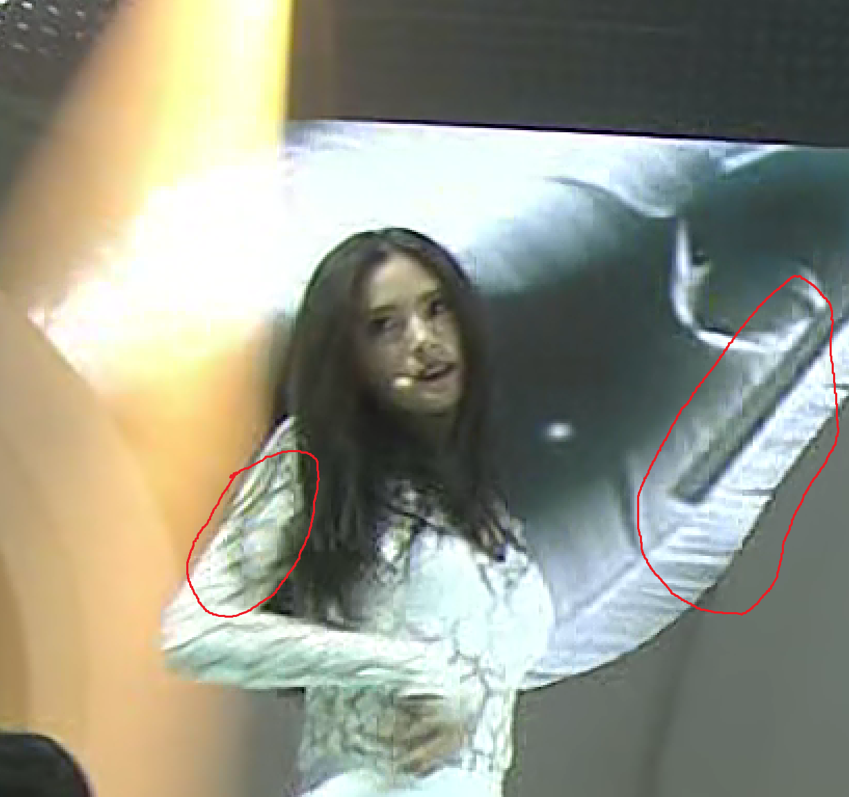

    I'm definitely a newbie to encoding and have used this forum repeatedly to get some help. I feel kind of bad, so if anybody knows of any comprehensive beginner's guides to filters, processes and such, I would be very grateful. Unfortunately, I don't really know where else to go to stock up on some knowledge, it seems really overwhelming.
    But to get to my point, I've recently downloaded many Stage Performances. I noticed that they have decent bitrate (I think) and are in 1080i, but it seems like many of them have slight to strong artifacting (varies strongly from file to file). In the most recent video that got me to write here, I don't think it looks that bad, but still, noticeably decreasing the "sharpness" of the picture. I've attached a screenshot of one randomly selected frame, I hope that gives an idea of what I'm talking about. Especially the arcs in the background seem to show some aliasing, if I'm not mistaken (both my eyesight and my knowledge of technical terms are pretty limited). Are there any filter and methods I could use to get a clearer, sharper picture? Neither CPU/GPU performance nor time should be an issue for me.
    To give an account of my knowledge of encoding, it's limited to using MeGUI and QTGMC to de-interlace those very performance videos (which I learned how to do here by following a guide. Thanks for that ). Other than that, I've sometimes used to convert to different formats and resolutions using XMedia Recode, since I found it very easy to use (complex options aside).
    Some file info:

    (This is the video after simply using QTGMC for de-interlacing, nothing else)
    If this is bothersome/too general, as I said, I completely understand and I'm sorry for going into this so naively and uninformed. I'm trying to learn though, since I find the matter quite interesting, but haven't found a good entry point.
Name:	Sequence 01.Still001.png

    You're referring to those mostly horizontal lines behind the girls? Looks to me like a video is being shown behind them as part of the performance and it's nothing to be removed or worried about.
  3. I was under the impression QTGMC does de-interlacing and doesn't change the quality much? But sure, that's a valid complaint, I will put up something from the original.
    The lines behind are one thing, but generally, if you look around the hair especially, I feel like the picture isn't quite as sharp as it could be. When the video's running, this is one of the better examples, but especially if you pause, you can see that the picture seems weird. But maybe this is normal. If you think I'm seeing things, I can go look for cases where the video quality definitely has been worse, just tell me, as I said, I'm a total rookie and always open to suggestions.
    I'm not sure how to cut something without re-encoding. I followed a suggestion on here to use VideoReDo. I hope this leaves the quality near untouched. I uploaded to MediaFire, I hope that is okay: http://www.mediafire.com/download/2hm4dx4jdd974rn
    And thanks a lot for taking an interest in my problem
  4. Yes, the curves do show some aliasing. But the remedy (an anti-aliasing filter or QTGMC's InputType=1 after it's been made progressive) will do more than just smooth them out and I wouldn't recommend it. And I don't think an average of 12.7 Mbps is high at all for a 1920x1080 interlaced video, or is even enough, and may be the cause of some of the problems, especially the softness, you're noticing. I don't know if it was captured this way or reencoded afterwards, before being made available for download.
    Maybe others will have some ideas but my own verdict is it already looks about as good as it's going to get. Pretty girls.

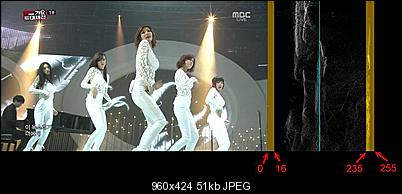

    Historgram() highlights the 0-15 and 236-255 areas in yellow:
    (I added black borders to that image to make room for the labels.) The total width of the graph is 256 pixels -- the number of values between 0 and 255 (inclusive).

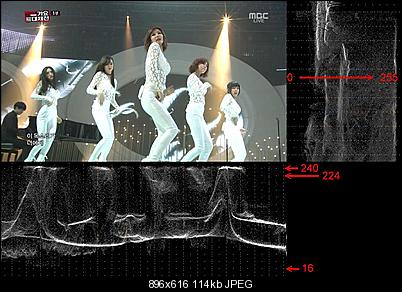

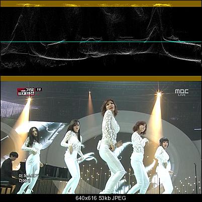

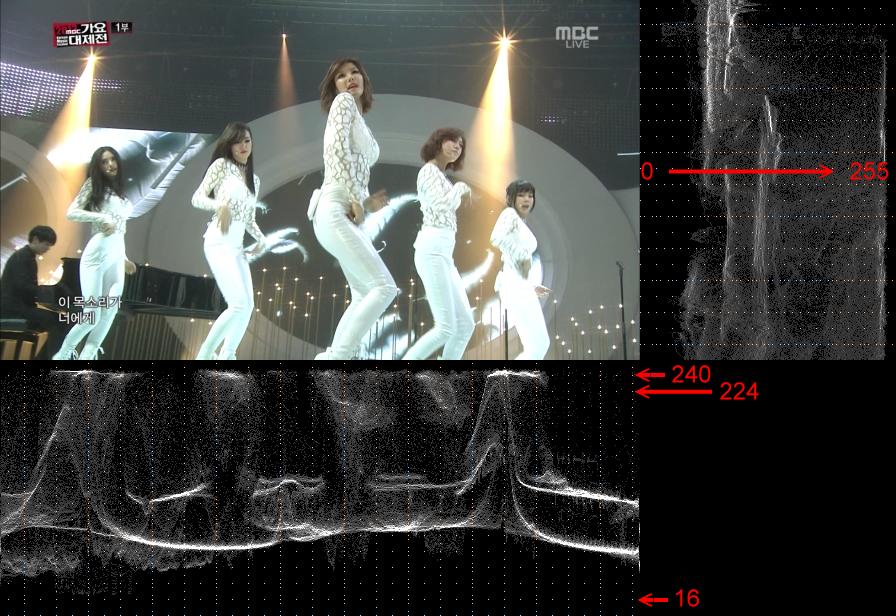

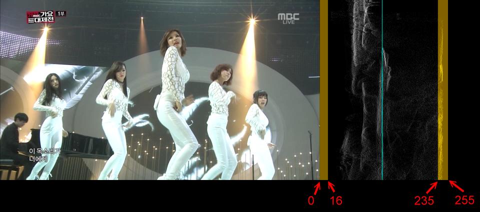

    I usually prefer the traditional horizontal histogram so I use TurnRight().Histogram().TurnLeft(). That leaves the histogram at the top of the frame:
    Here 0 is at the bottom of the graph, 255 at the top.
    Note that this isn't really a histogram, it's a waveform monitor. It's basically what you would see on an oscilloscope monitoring the luma signal.
    VideoScope() doesn't highlight the out-of-bounds areas but if you enable the TickMarks one row of dots marks Y=16. Unfortunately there's no marking for Y=235. But the scale is the same as Histogram(), 256 pixels, so you can estimate where it is.
    Originally Posted by bschneider View Post
    Generally, I know next to nothing concerning colours, their values and their mechanics on computers. I'm not sure if I understood the underlying issue exactly either, basically, it sounded like YUV should only have values from 16 to 235 but some recording/converting software assigns values below 16, losing detail in the dark areas because YUV will display 0 to 15 equally as black as 16, although originally, 0 was darker than, say, 12? And the same for bright areas and values above 235. Is that it?
    Yes. A properly calibrated display will show Y=0 and Y=16 the same shade of black. If they don't, normal video will look washed out (not enough contrast) because blacks at Y=16 will be dark grey, not black. The top end is less critical in terms of obvious image quality.

  24. Originally Posted by jagabo View Post
    Histogram() highlights the 0-15 and 236-255 areas in yellow:
    [Attachment 25863 - Click to enlarge]
    So in the case of my sample, there area no issues with darks (no dots in the are 0-15), but some with brights (plenty dots from 236-255), correct? Actually, it looks like all the shades are a bit too bright, you could move it all down a bit and it would still not touch the area below 16. That way, you don't even need to warp the proportions of the brightness scale, right?

  25. Originally Posted by bschneider View Post
    Yes.
    Yes, in the sample images I posted you could subtract 10 or so from all the Y values (ColorYUV(off_y=-10) to bring the peaks down to 235. And since there are no pixels with luma below 26 you wouldn't have any over-dark pixels. But there are some other parts of the clip where the darks are down around 22. If you subtract 10 from those they would be too black.

    So, I tried around with some filters for quite some time, didn't want to go to crazy, so I stuck mostly to what you suggested earlier. When using aWarpSharp, I noticed that "warp" is indeed a good description hehe, it seemed to distort the proportions somewhat, it looked odd. This is the code I used now:
    MPEG2Source("C:\Program Files (x86)\VirtualDubMod\tests\AfterSchool.d2v")
    ColorYUV(off_y=-6)
    QTGMC(Preset="Slower", EZDenoise=2.0)
    DeBlock_QED(quant1=20, quant2=22)
    asharp(1,3)
    I used both EZDenoise and DeBlock_QED, it seemed to give a good picture, may be a placebo though, I'm getting a bit tired, it might not actually do anything.
    What is still left are some large blocks, especially when magnifying. This is 300% magnifying, I marked some spots that I found odd (is this still just blocking/artifacts?), and additionally, I would like if the face looked a bit... smoother? Can you help me identify what the problem is? Click image for larger version
    I found it interesting to search through the avisynth wiki a bit, but find myself baffled by all the terminology. Some of it is hard to look up, I couldn't find anything on contra-sharpening for example. So I still don't know what it does and couldn't find anything via Google either. Just to explain some of my issues with expanding a lot on my own, I sometimes ran into dead ends.

    I know you're still working on the 1st clip, especially the macroblocking, but just to mention the 2nd clip has other issues like oversaturation. Oversaturaton and high levels (>235) reduce the amount of details that can be visible in those bright regions and saturated regions when it's rendered to RGB for display
    RE: Macroblocking - basically the details are non recoverable. You would need a better source. The stronger the deblocking settings and filters applied, the more smooth the image and fewer fine details will be retained . It's really a balance and up to subjective tastes
