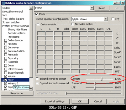

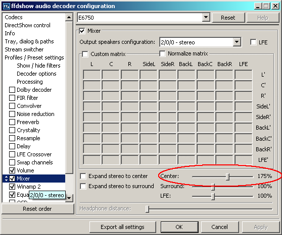

  6. If you're interested, I posted some details regarding how I "compress" the audio on playback in this thread. As I use a PC for playing video I compress the audio on playback rather than encode it compressed, but there's no reason why you can't compress it while encoding using the same method.
    One thing I seem to have forgotten to mention in that thread.... I use ffdshow's mixer filter to downmix 5.1ch audio to stereo, and I set it to boost the volume of the centre channel, given that's where the dialogue tends to be.
