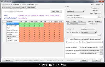

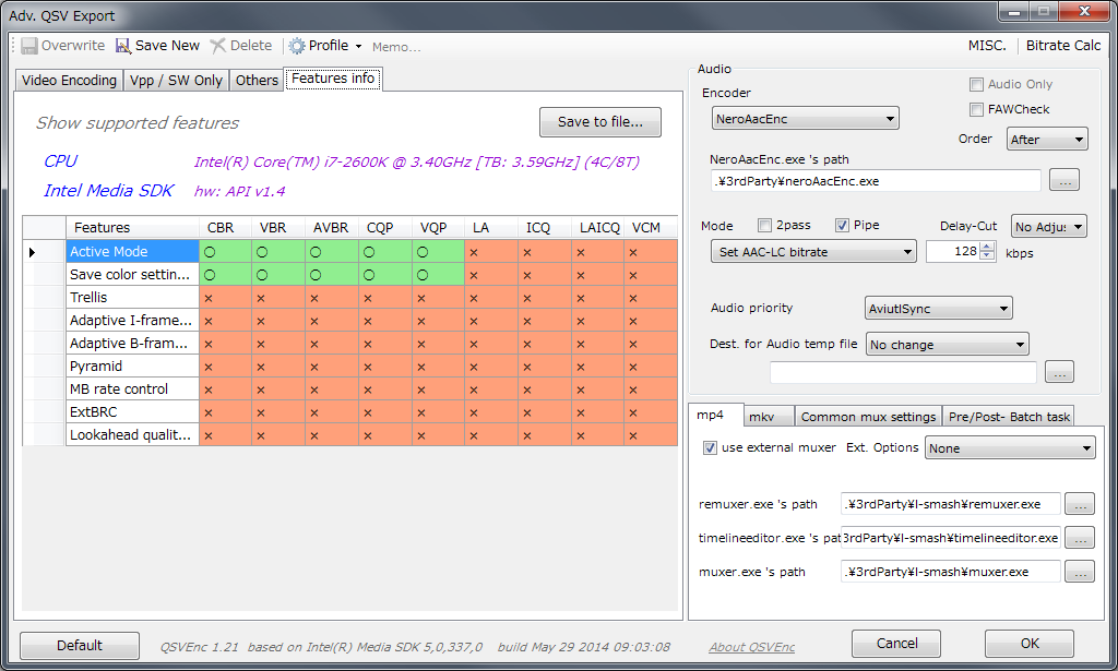

    Also note the la and la-icq options need at least QSV API v1.8 to work(both hardware and software API),
    meaning that the following will not work....

  11. can you post the full commandline you've used and what message did you get when trying to use icq/la-icq?
    QSVEncC --check-features already indicates that icq&co are not supported. (they are using handbrake on my i7-4770k (desktop) and my i7-4702MQ (laptop).
    QSVEncC (x64) 1.19 by rigaya, build Mar 25 2014 23:41:23
    based on Intel(R) Media SDK Encoding Sample 5,0,337,0
      avi reader: enabled
      avs reader: enabled
      vpy reader: enabled
    Media SDK Hardware API v1.8
    Supported features:
                      CBR   VBR   AVBR  CQP   VQP   LA    ICQ   LAICQ VCM
    RC mode available  o     o     o     o     o     o     x     x     x
    VUI info output    o     o     o     o     o     o     x     x     x
    Trellis            o     o     o     o     o     o     x     x     x
    Adaptive_I         o     o     o     o     o     o     x     x     x
    Adaptive_B         o     o     o     o     o     o     x     x     x
    B_Pyramid          o     o     o     o     o     o     x     x     x
    Ext_BRC            o     o     o     x     x     x     x     x     x
    MBBRC              o     o     o     x     x     x     x     x     x
    Lookahead Quality  x     x     x     x     x     o     x     x     x
    Media SDK Software API v1.8
    Supported features:
    RC mode available  o     o     o     o     o     x     x     x     x
    VUI info output    o     o     o     o     o     x     x     x     x
    Trellis            x     x     x     x     x     x     x     x     x
    Adaptive_I         o     o     o     o     o     x     x     x     x
    Adaptive_B         o     o     o     o     o     x     x     x     x
    B_Pyramid          o     o     o     o     o     x     x     x     x
    Ext_BRC            x     x     x     x     x     x     x     x     x
    MBBRC              x     x     x     x     x     x     x     x     x
    Lookahead Quality  x     x     x     x     x     x     x     x     x
    When calling
    mencoder -lavdopts threads=8 -really-quiet -of rawvideo -o - -ovc raw -demuxer lavf -vfm ffmpeg -noskip -vf scale,format=i420 -forcedsubsonly -nosub -nosound -mc 0 "C:\Users\Selur\Desktop\TEST-A~1.MP4" | ffmpeg -loglevel fatal -threads 8 -an -sn -r 25 -pix_fmt yuv420p -s 640x480 -f rawvideo -i - -r 25 -pix_fmt yuv420p -f yuv4mpegpipe - | QSVEncC --y4m -i - --icq 23 --fps 25000/1000 - --sar 1:1 "E:\Temp\test_13_23_22_4710_01.264"
    I get:
    Error: Unknown options
    Since on both machines icq&co work in handbrake they sure are supported through the Intel SDK.
    Regarding the Vista support, problem seems to be that the SDK / buidl enviroment is Windos 7/8 in which SetThreadErrorMode is part of the kernel32.dll, which it isn't in Vista. (see: Changes in Microsoft Windows 7 vs Microsoft Vista SP1: kernel32.dll
    Cu Selur
  12. For the --quality issue, I have tested with the following:
    Source AVI:
    Format : AVI
    File size : 1.30 GiB
    Duration : 7mn 2s
    Overall bit rate : 26.3 Mbps
    Writing library : This file was made by AviUtl 1.00.
    Video
    Format : Lagarith
    Codec ID : LAGS
    Duration : 7mn 2s
    Bit rate : 24.9 Mbps
    Width : 640 pixels
    Height : 360 pixels
    Display aspect ratio : 16:9
    Frame rate : 30.000 fps
    Color space : YUV
    Chroma subsampling : 4:2:0
    Bit depth : 8 bits
    Bits/(Pixel*Frame) : 3.604
    Stream size : 1.23 GiB (95%)
    Audio
    Format : PCM
    Format settings, Endianness : Little
    Format settings, Sign : Signed
    Codec ID : 1
    Duration : 7mn 2s
    Bit rate mode : Constant
    Bit rate : 1 411.2 Kbps
    Channel(s) : 2 channels
    Sampling rate : 44.1 KHz
    Bit depth : 16 bits
    Stream size : 71.1 MiB (5%)
    Alignment : Aligned on interleaves
    Interleave, duration : 33 ms (1.00 video frame)
    Interleave, preload duration : 33 ms
    Encode commandline:
    qsvencc --quality higher -i "testvid.avi" -o "qsv32test.264"
    AND
    qsvencc --quality faster -i "testvid.avi" -o "qsv32test.264"
    Both completed successfully with the following outputs, respectively:
    \QSVEnc_1.21\QSVEncC>qsvencc --quality higher -i "testvid.avi" -o "qsv32test.264"
    QSVEnc 1.19 (x86), based on Intel(R) Media SDK Encoding Sample 5,0,337,0
    CPU Info Intel(R) Core(TM) i7-2600K CPU @ 3.40GHz [TB: 3.70GHz] (4C/8T)
    Media SDK impl QuickSyncVideo (hardware encoder), API v1.4
    Input Frame Info avi: lags(yv12) -> nv12, 640x360, 30/1 fps
    Output Video H.264/AVC High @ Level 3
    640x360p 1:1 30.000fps (30/1fps)
    Encode Mode Constant QP (CQP)
    CQP Value I:24 P:26 B:27
    Target usage 2 - higher
    Ref frames 2 frames
    Bframe Settings 3 frames
    Max GOP Length 300 frames
    Scene Change Detection on
    Slices 1
    Memory type d3d9
    Input Buffer Size 3 frames
    Intel iGPU ID 2nd GPU
    Processing started
    [98.2%] 12444 frames: 367.65 fps, 736.58 kb/s, remain 0:00:01
    Processing finished
    \QSVEnc_1.21\QSVEncC>qsvencc --quality faster -i "testvid.avi" -o "qsv32test-faster.264"
    CPU Info Intel(R) Core(TM) i7-2600K CPU @ 3.40GHz [TB: 3.60GHz] (4C/8T)
    Output Video H.264/AVC Main @ Level 3
    Target usage 6 - faster
    Ref frames 2 frames
    Slices 1
    Memory type d3d9
    Processing started
    [97.9%] 12416 frames: 308.22 fps, 781.49 kb/s, remain 0:00:01
    Processing finished

  19. From rigaya:
    >>MaverickTse様
    >ICQモードについて
    3621ドライバで本来はICQモードが使えるはず、ということでしょうか…。
    QSVEncの機能情報タブで表示しているのは、「MFXVideoENCODE_Query」を使ってチ ェックした結果でして、そこで「×」と出るので、てっきり3621でもダメなのだと思っていたのですが…。 どうしてICQが使えないのか、調べてみます。
    >Vista
    正式にサポートする予定はありません。これはVista環境がなく、確認できないためです。(Win7と8 .1は確認しています)
    ただ、たぶん動くと思います。積極的に動かないように作ってるわけではありません。
    >>3621ドライバ
    うーん、API 1.10というのも妙ですよね、Media SDK 2014 R2もAPI 1.9のはずなので、「1.10ってどっからでてきた?」という感じです。わたしが気づいてないだけでしょ うか…。
    The following are my translation:
    >>About ICQ Mode
    The 3621 Driver was supposed to be able to use ICQ mode...
    Since feature info was checked using "MFXVideoENCODE_Query" and there is a X on ICQ, that means Driver 3621 actually cannot use ICQ...But why is it so...I need to check.
    >Vista
    No plan to support because I don't have Vista machine and therefore cannot test that. (Confirmed to work on W7 and 8.1 )
    However, I did not deliberately make it fail on Vista.
    >> 3621 Driver
    umm... API 1.10 is weird. Media SDK 2014 R2's API is 1.9 only, so where is that 1.10 came from? Am I missing something....
    It seems that rigaya did not visited this thread(or at least did not pay attention to it), but since he is going to investigate the ICQ mode and 3621 Driver issue, I suppose quite a lot of things will be uncovered and be dealt with sooner or later.
  20. Thanks for keeping us here up to date
  21. Intel's response on the API version problem:
    https://software.intel.com/en-us/forums/topic/516207
    About Vista:
    Look at the release notes of Media SDK 2013 and 2014... there is no "Vista" under system requirement. Meaning Intel dropped support for Vista in the recent SDKs.
    Rigaya himself did not use SetThreadErrorMode in his code.
  22. Ah, okay. Thanks to him and yourself for clearing that up!

  25. Updates:
    http://rigaya34589.blog135.fc2.com/blog-entry-484.html
    Summary:
    Fixed the ICQ unusable issue
    More check on interlace-compatibility for different encoding modes
    Better AVX2 utilization
    DL:
    http://1drv.ms/1gd27qw
  26. Nice! Thanks for the Info!
    '--check-features' now shows:
    Supported features:
    RC mode available  o     o     o     o     o     o     o     o     o
    Interlace          o     o     o     o     o     o     o     o     o
    VUI info output    o     o     o     o     o     o     o     o     o
    Trellis            o     o     o     o     o     o     o     o     o
    Adaptive_I         o     o     o     o     o     o     o     o     o
    Adaptive_B         o     o     o     o     o     o     o     o     o
    B_Pyramid          o     o     o     o     o     o     o     o     o
    Ext_BRC            o     o     o     x     x     x     o     x     o
    MBBRC              o     o     o     x     x     x     o     x     o
    Lookahead Quality  x     x     x     x     x     o     x     o     x
    Sweet!
